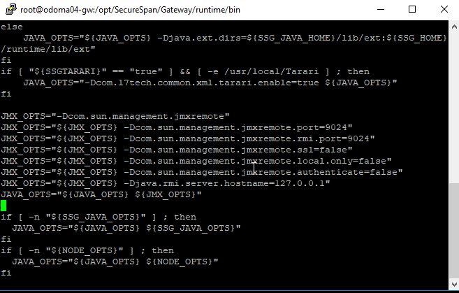

1.2 How I set the JVM properties - my workaround for not getting step 1.1 to work.
Eventually I edited :
/opt/SecureSpan/Gateway/runtime/bin/gateway.sh
and added those parameter directly into the file :
JMX_OPTS="-Dcom.sun.management.jmxremote"
JMX_OPTS="${JMX_OPTS} -Dcom.sun.management.jmxremote.port=9024"
JMX_OPTS="${JMX_OPTS} -Dcom.sun.management.jmxremote.rmi.port=9024"
JMX_OPTS="${JMX_OPTS} -Dcom.sun.management.jmxremote.ssl=false"
JMX_OPTS="${JMX_OPTS} -Dcom.sun.management.jmxremote.local.only=false"
JMX_OPTS="${JMX_OPTS} -Dcom.sun.management.jmxremote.authenticate=false"
JMX_OPTS="${JMX_OPTS} -Djava.rmi.server.hostname=127.0.0.1"
JAVA_OPTS="${JAVA_OPTS} ${JMX_OPTS}"
Noting the highlighted extra -Dcom.sun.management.jmxremote.rmi.port=9024" parameter.

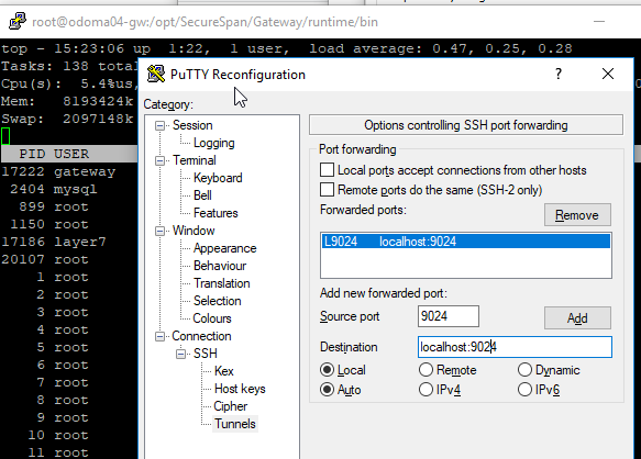

3. Setup SSH access to forward port 9024 to the gateway
In putty or similar, we setup ssh to tunnel from the local machine on 9024 to forward to localhost:9024 on the gateway :
Then start a putty session to the remote API Gateway machine.   Once you are connected it's best to get to the console access and run some command, such as "top" that keeps the connection active.

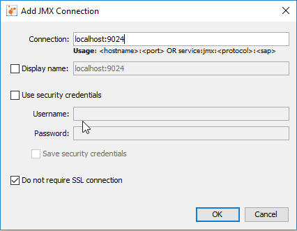

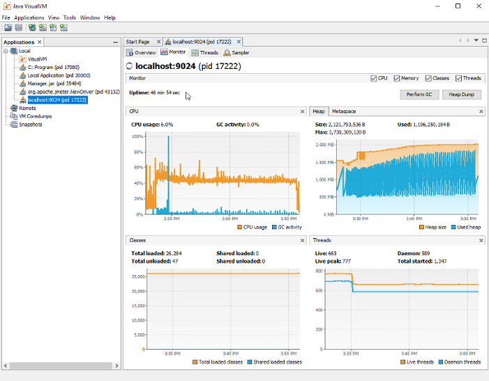

For JVisualVM, to connect. we pick the "Add JMX Connection" and put in "localhost:9024"
If you have your putty tunnel active then hopefully you see some stats from the remote JVM e.g:

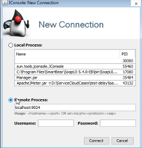

5. Run JConsole
Again for jconsole, you need a roughly compatible version of JDK on your PC.   From the bin directroy on the java JDK, installed on your local machine locate the JConsole.exe file, and double click that :
For JConsole, to connect. we pick the "Remote Process" and put in "localhost:9024"
Then hopefully it too displays statistics from the remote Gateway JVM :
