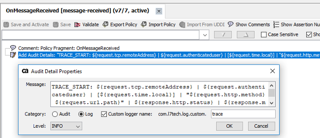

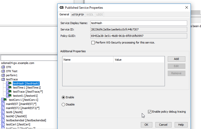

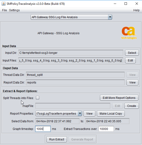

  1. We enable some global policy to trace when messages and services are started and completed.
  2. Then enable (specific) trace logging for the services we want to dig into.

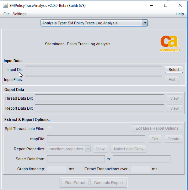

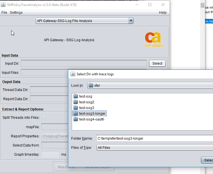

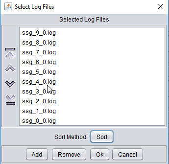

  3. Capture the ssg_X_X.log from the gateway.

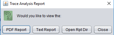

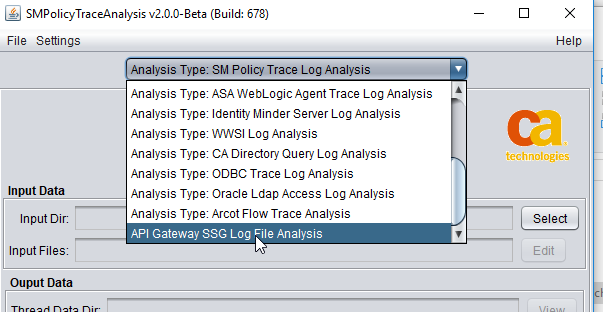

  4. Run the SMPolicyTraceTool over the logs.  It parses them, identifies threads & transactions and builds a pdf report file and sub-directory of transactions that took longer than the cutoff time.
3. Results Overview
The pdf report is broken into sections.  The first is "ProcessRequest" which is summary for all services, then there is section for each Service, and finally some summary graphs and any long transactions (up to a limit).

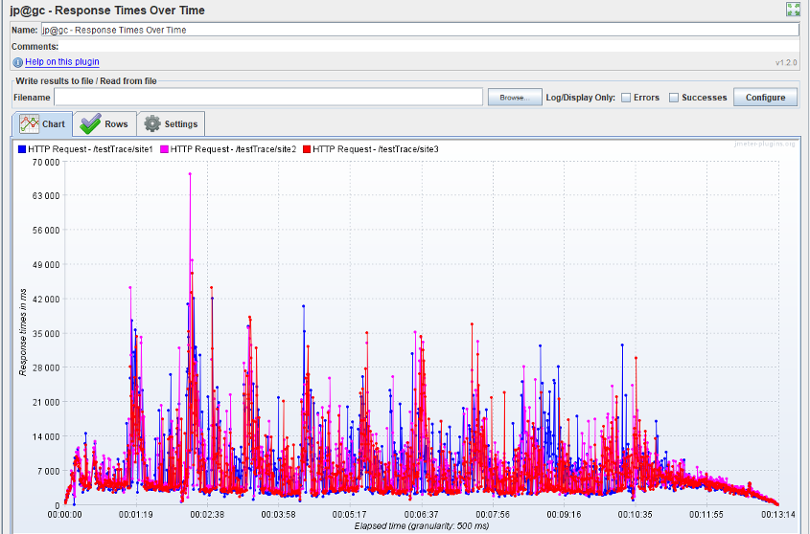

These results are for a simple load test using jmeter, and are calls to a service /testTrace/* that delegates to three other services on the same gateway.  The jmeter setup has 800 threads that loop for 100 times, and ramp up over 5sec. giving 78,666 calls that occur over about 13min.
Note: reviewing the screenshots however, I'd dropped off some of the training logs, and so the analysis here is only on about 3min of the trace.

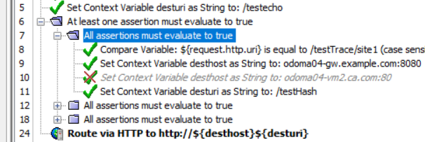

Section X.4 SrcLine Graph plots a bar graph summary of all the policy transitions observed in the trace log and the summary of the amount of time (over all threads) that was spent time in each of those transitions.
So we can see above that transition from policy # 6 -> 24 was definitely the transition where most of the threads processing service /testTrace/* spent most of their time.   This one is pretty obvious, but if you look at the attached pdf reports in this article, you can see different distributions.
While the graph is good to get clear picture of where most time was spent - we also have that in table format as well.
3.1.2 SrcLine Table
Here is the table entry for the above transition where most time was spent :
So over all threads processing this service, the total time spend doing this transition from 6 -> 24 was : 27,483 sec. or 458 min, or 7.6 hr
We can see this transition was called 16,097 Times  with an av response time : 1,707.343 ms and response range of (min: 4 ms, max: 23,286 ms),  (it is the small print last line in table - I'll improve the format for ssg logs in some release).
The table also as a sample give the details of the first transition 6->24 transition that it found in the trace logs.  - these are a bit messy, since there is a lot of details in each trace line - I'll improve the format for ssg logs in some release.

Here is the start of the transaction, from global fragment, message-received and pre-service :
2018-11-04T22:38:06.757+1100 INFO 6261 com.l7tech.log.custom.trace: -4: TRACE_START: 192.168.154.1 | | [2018-11-04T22:38:06.757+11:00] | "GET /testTrace/site2" | 0 |
2018-11-04T22:38:06.757+1100 INFO 6261 com.l7tech.log.custom.trace: -4: TRACE_PRESERVICE: service.name=testTrace service.resolutionUri=/testTrace/* 192.168.154.1 | | [2018-11-04T22:38:06.757+11:00] | "GET /testTrace/site2" | 0 |

We setup the following four global policy entries, for each of them we do the following:
a) Add the TRACE_*** entry
b) Ensure it is write to log not audit (if we write to audit there is db connection, so write to log only likely to have less impact on the gateway performance)
c) Put in the custom logger name for all entries to be com.l7tech.log.custom.trace - makes it easier to pick out.
Note1: The policy parts are all contained in xml files attached at the of this document - once you create your global policy you can cut-and-paste the xml into the policy manger.
Note2: If you already have one of global policy you can just append these policy assertions to your existing global policy - it will have the same effect.
Note3: If you just add the OnMessageReceived, and OnMessageCompleted, and even OnPreService, and OnPostService it will still give good overall trace information without much degradation of the service.
The Global policies and their entries are : (see attachments at the end of this article, you can cut-and-paste them directly into your global & trace policies)
OnMessageReceive [message-received]
TRACE_START: ${request.tcp.remoteAddress} | ${request.authenticateduser} | [${request.time.local}] | "${request.http.method} ${request.url.path}" | ${response.http.status} | ${response.mainpart.size}
OnPreService [pre-service]
TRACE_PRESERVICE: service.name=${service.name} service.resolutionUri=${service.resolutionUri} ${request.tcp.remoteAddress} | ${request.authenticateduser} | [${request.time.local}] | "${request.http.method} ${request.url.path}" | ${response.http.status} | ${response.mainpart.size}
OnPostService [post-service]
TRACE_POSTSERVICE: service.name=${service.name} service.resolutionUri=${service.resolutionUri} ${request.tcp.remoteAddress} | ${request.authenticateduser} | [${request.time.local}] | "${request.http.method} ${request.url.path}" | ${response.http.status} | ${response.mainpart.size}
OnMessageComplete [message-completed]
TRACE_END: ${request.tcp.remoteAddress} | ${request.authenticateduser} | [${request.time.local}] | "${request.http.method} ${request.url.path}" | ${response.http.status} | ${response.mainpart.size}
4.1.2  Trace Policy
The trace policy is much the same as the global policy.
Note: it is different from the default generated trace policy - so you will need to modify it - you can cut-and-paste the .xml attachment at the end of this document);
Again, we write to log, not to audit, and to the com.l7tech.log.custom.trace logger name.
The trace log entry is :
[Internal Debug Trace Policy]
TRACE: service.name=${trace.service.name} service.resolutionUri=${trace.var.service.resolutionUri} policy.name=${trace.policy.name} policy.guid=${trace.policy.guid} assertion.numberStr=${trace.assertion.numberStr} assertion.shortname=${trace.assertion.shortname} assertion.start=${trace.assertion.start.ms} assertion.latency=${trace.assertion.latency.ms} status=${trace.status}
4.2 Enable Debug on Service
For the service you want detailed trace of click "enable policy debug trace" (bottom right of screen) .
4.3 Run Load Test
I used jmeter to run the test, 700 threads, for 100 requests, here for a pretty picture for this section is one of the output reports.

4.2.2. Startup
The Program starts up blank looking as follows :
4.2.3 Select Log Type to Analyze
Yon need to set the analysis type (forgetting to do this is common mistake - I intend to code around it some day).  Here we need to select the last one,
4.2.4 Select Input Directory
4.2.5 Select log files
The ssg log files in that directory will generally be auto selected.  You can add/remove them via the buttons.
And remember to click the "sort" button (it should be automated) but is needed to get them into sorted order (the sort method checks timestamps at start/end of files and also looks for large gaps).
4.2.6 All Entered - press "Run Extract"
After entry, from the main screen you can edit the details again or select "Run" to run the analysis.
4.2.7 Processing - Progress Screen.
The run scree gives some estimate of time it will take, and also for memory usage.
4.2.8 Display Report
After run - select "PDF Report" for the pdf report, there is also a text version, and Open Rpt Dir will give you directory with extract of long or incomplete transactions.
4.2.9 View pdf report.
And hopefully now you are looking at the pdf report.
