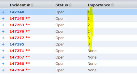

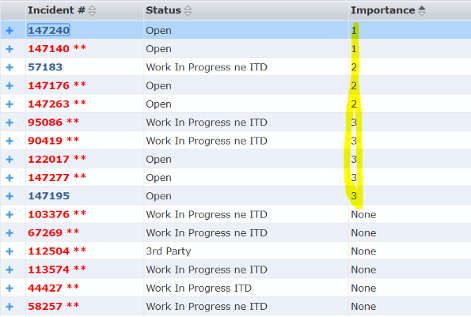

    I would like to have default Ticket list sorting  by particular field and for particular role. I try to use lsEnd sort attribute for this purpose, but when list of tickets is very large, It seems that only about 500 top tickets are sorted properly, the other appears at the right positions only if i do the sorting by this field manually.
    Any suggestions on this?
    Edit:
    if i modify domset it works fine
    MODIFY FACTORY in
    DOMSET in_list_web_active_only "zimportance=zimportance.sym, open_date ASC, id DESC, mintime=min(attached_slas.time_to_violation), mintgt=min(target_times.target_time), status=status.sym, priority=priority.sym DESC, ref_num" "" STATIC
    WHERE "active=1" ;
    But if i try to do this on form level the results are wrong
    <PDM_MACRO name=lsEnd isticketfactory=1 sort="zimportance=zimportance.sym ASC">

    It sounds like performing this from the form level would bump into the default 500 list limit setting.
    See here: Increase list size page record
    As such, it is not recommended to use the variable ListAllMaximum to overcome this, but you could test out an increase to 600 to confirm that is is the culprit.
