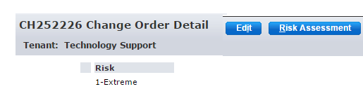

    When raising a change order, users need to fill out a risk assessment.
    The risk assessment populates the field RISK as per below.
    There is a requirement to prevent users from initializing the change order if the risk field is NULL.

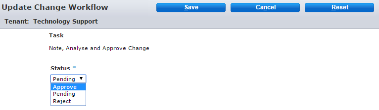

    Now the user will go and initialize change
    The user is now in the detail_wf panel

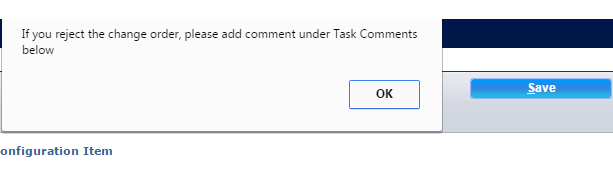

    In the detail_wf panel, we currently have a function presaveTrigger()
    The preSaveTriger states that
    IF the user chooses reject AND the comment field is NULL
    THEN an alert message will appear.
    See context below
