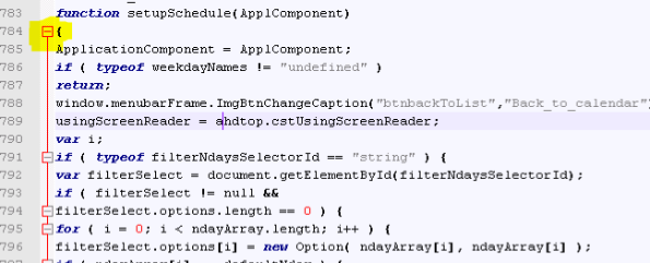

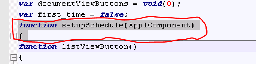

    Ok I think the easiest way will be to copy setupSchedule(ApplComponent) to 'list_chgsched.htmpl', I this case you will have original script for analysts and custom for employees. To do that I would suggest you to use notepad++.
    1. Open 'list_chgsched.htmpl' in notepad++ and search for function setupSchedule(ApplComponent)
    2. Once you find your function you will see minus sign on the left of it (marked in yelow)
    3. Click on minus sign this will collapse function, copy lines marked in my next picture
    4. Paste copied content in your custom 'list_chgsched.htmpl' file before </script> tag
    5. Rename copied function to setupScheduleemp(ApplComponent) and delete the following line: window.menubarFrame.ImgBtnChangeCaption("btnbackToList","Back_to_calendar");

    Great instructions, thanks.  Just one more question, and I think I'll have it.. My Notepad ++ doesn't have the plusses/minuses to collapse or expand the sections.  Is that a view I need to turn on, or a plug-in that I need to add?
  • 17.  Re: SDM, 12.7 - Link to the change calendar
    Posted Apr 25, 2015 12:04 PM
    I think you need to tell to notepad that this is javascript or html. There is somewhere in toolbar menu

    But I'm not finding that code in the list_chgsched.htmpl file -- it's in the schedule.js file -- did you mean to say copy it from there, into the custom 'list_chgsched.htmpl' file?
