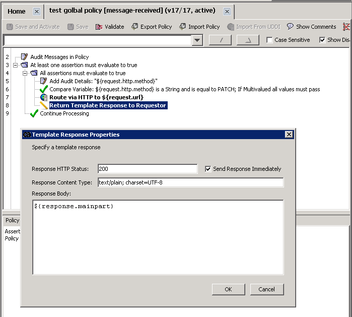

    Hi,
    You may try creating a message-received global policy to compare the HTTP method, and replace it to POST if it's PATCH(in line 7, specify POST in "HTTP Method" field. )
    It will call the service twice, one for PATCH(failed), another for POST, so you need the line 8 to return the response for POST (check the "Send Response Immediately" option).
    It will be better to upgrade the gateway.
