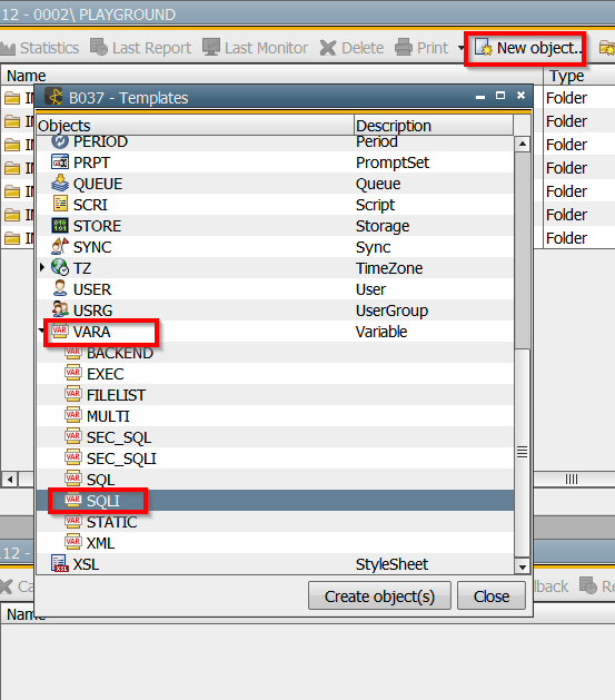

    As stated, to achieve this, you would need a SQLI Variable (in AE = VARA.SQLI (which is an Object))
    x69a1awsvuu0.pnghttps://us.v-cdn.net/5019921/uploads/editor/kv/x69a1awsvuu0.png" width="553">
    Once you have added this, you need to create the corresponding SQL statement to fetch the 'running jobs'. After that you can export them.
    Hope this helps :)
