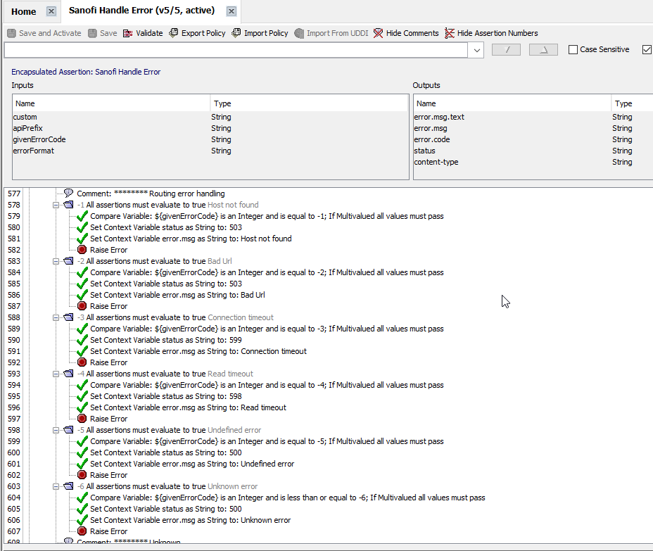

    Extracted from one of our API which handle all HTTP routing errors:
