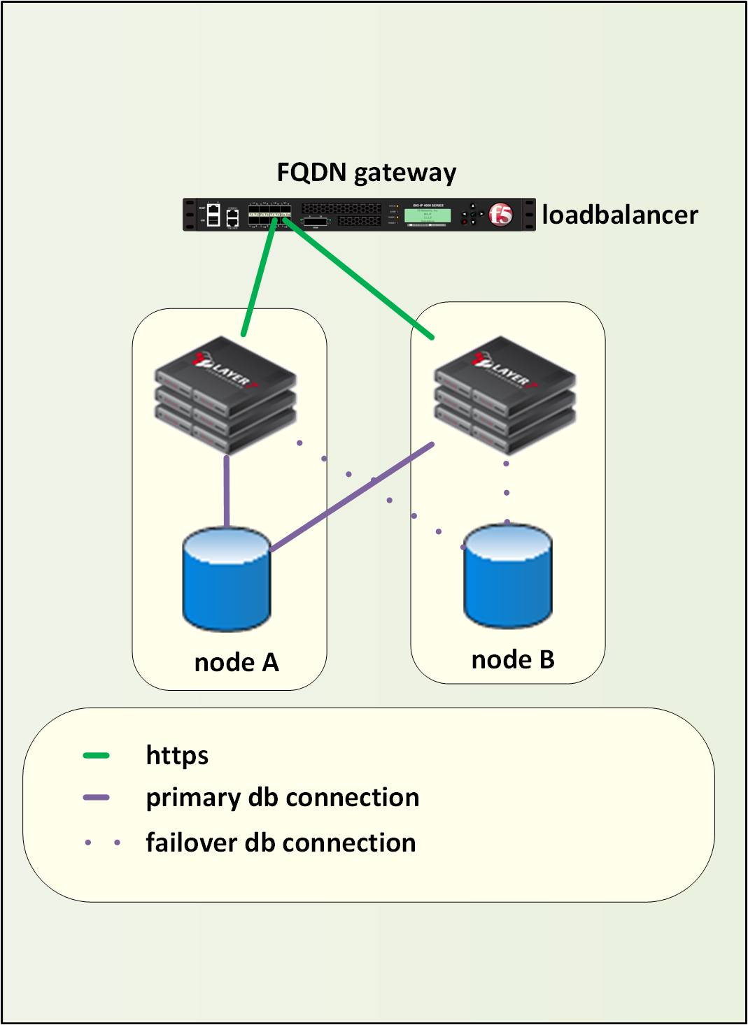

    I am wondering how to upgrade my gateway cluster nodes without downtime for the customer. We have 10.0 appliance gateways.
    cluster configuration
    We have configured the gateway nodes as displayed in the image. These settings were recommended by our integrator. Node A is primary, Node B is secondary. During normal upgrades or security patches, it's perfectly possible to route the loadbalancer to a single node, patch the other, reboot and switch to the other node. Production is guaranteed. However, when you have a minor or major release (for example 10.0 to 10.1) you have a database upgrade. In that event, i see no possible way to upgrade a single node first, and process the traffic by the other node without downtime. Even when you disconnect the databases from one other, you'll have to re-establish replication at one point. Re-initializing replication requires that both nodes are down.
    Is there any way to guarantee uptime during a major/minor upgrade of the gateway?

    Thank you very much Daniel,
    This procedure takes a bit of time, but it's indeed a way to guarantee uptime.
