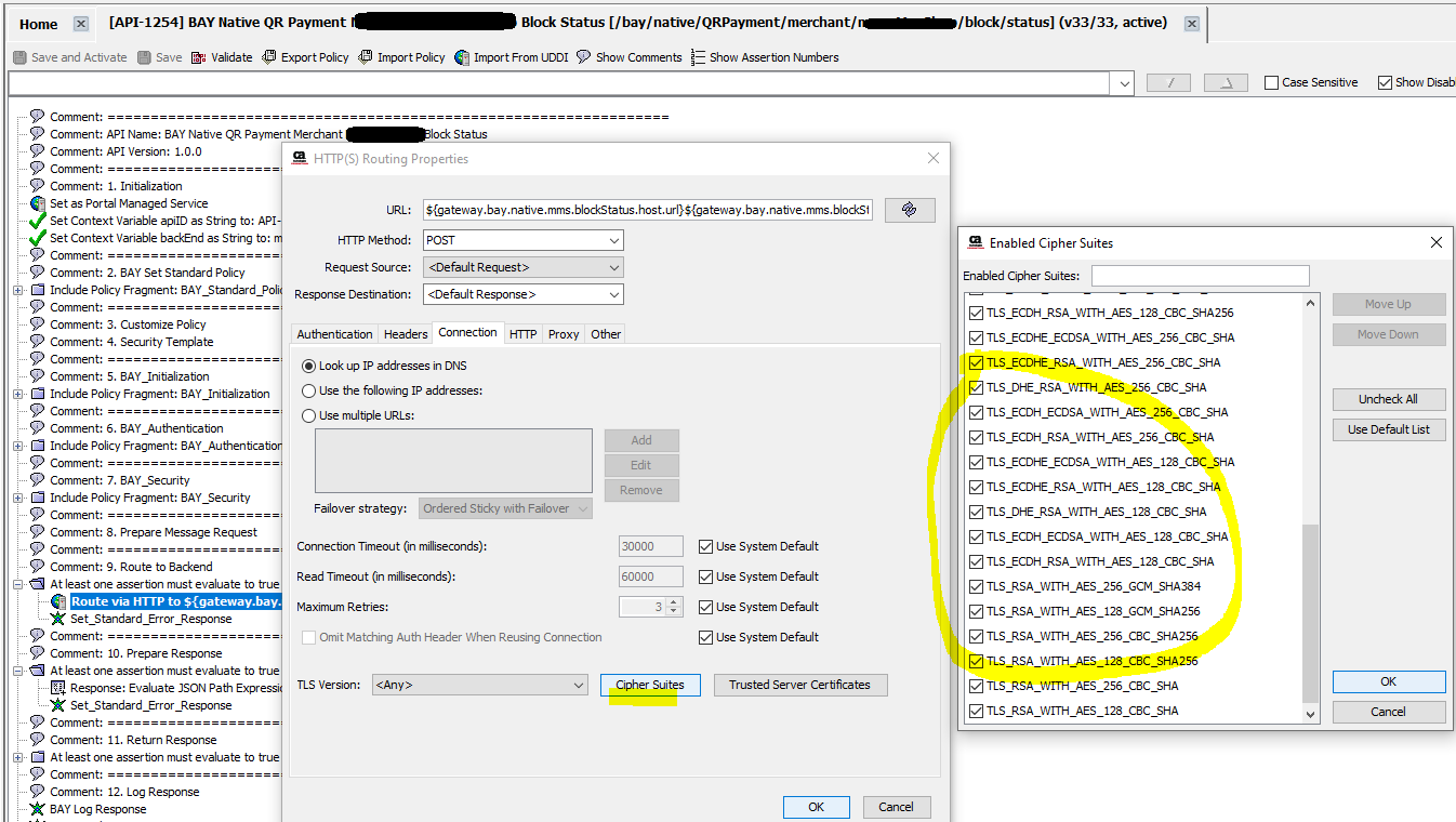

    There is an urgent need to update cipher suites in the Route via HTTP(s) assertion for >1200 APIs.
    This is to resolve this error:
    Problem routing to https://<URL>:8443/api/webportal/api/merchants/block-merchant-efs. Error msg: Unable to obtain HTTP response from https://URL:8443/api/webportal/api/merchants/block-merchant-efs: Received fatal alert: handshake_failure
    Does updating cipher suites in Manage Listen Ports > SSL/TLS Settings tab resolve the error seen above?
    If not, is there a faster way to update the cipher suites for all 1200 APIs?

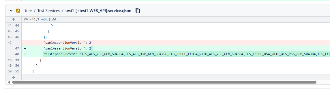

    Hello Ain Abdullah,
    This should be possible with graphman.
    If you use Route via HTTP with the default tls configuration, you won't get any tls properties in the export. But if you change the tls configuration, graphman export will give you an additional attribute called tlsCipherSuites.
    I did a quick test and saw the following diff.
    The same should be ok with the restman.
