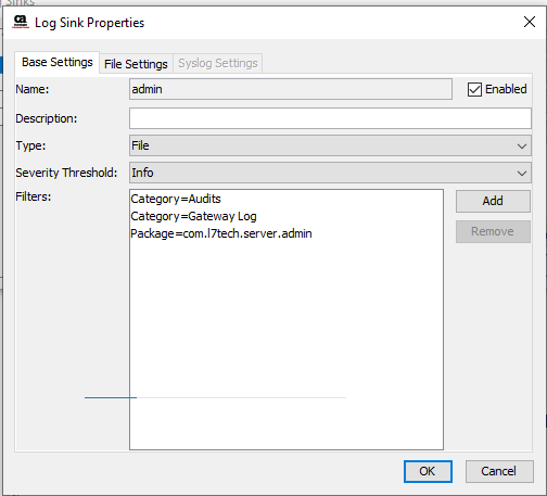

    What gets written to the log file is determined by the configuration of your log sink.
    By default, the ssg log sink includes both "Category=Audits" and Category="Gateway Log" with no additional filters.
    If you want a log with just admin activities (in the logs as com.l7tech.server.admin) including log in/outyou could try a log sink like below.   In my testing it gets the login and logout events, and other admin events.
    Keep in mind that your log.levels Cluster Wide Property plays a big role in what actually hits the log sinks.  For example if you had modified it and set "com.l7tech.level = Warning" the log in/out messages would never reach the log sink filters.  In that case you would need to add a log.levels line like "com.l7tech.server.admin.level = INFO" to ensure those messages make it to the sink.
    I hope this makes sense?
