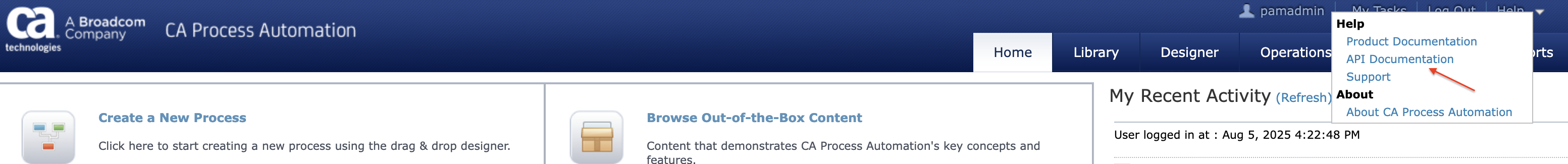

    Below is the base url for all rest services exposed by ITPAM.
    http(s)://<hostname>:port/api
    Once authenticated, you can view the swagger help where you can access all exposed rest services and try out the same.
    The same can be accessed after logging into the ITPAM UI from the Help section by clicking the API Documentation link.
