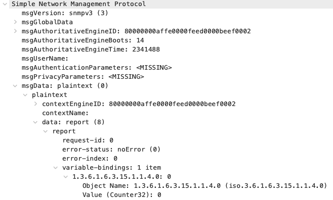

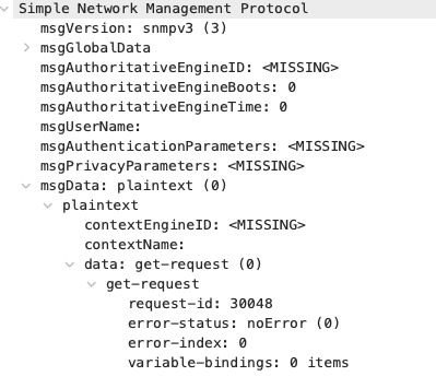

    i've moved from snmpv2 to snmpv3 and i'm no longer seeing any events
    when i run a packet capture i can see my router sends a get-request to the snmp server
    spectrum then replies with a report with the wrong engineid
    can i force spectrum to rediscover the router, i don't want to delete/remove it in case i lose the old logs

    thanks to anyone taking the time to look at or respond to this - greatly appreciated
    router get-request to nms
    repsonse to router get-request

    One thing to try is to issue the 0x10333 update action to the VNM model. This action clears the v3 cache.
    https://knowledge.broadcom.com/external/article?articleNumber=230117
