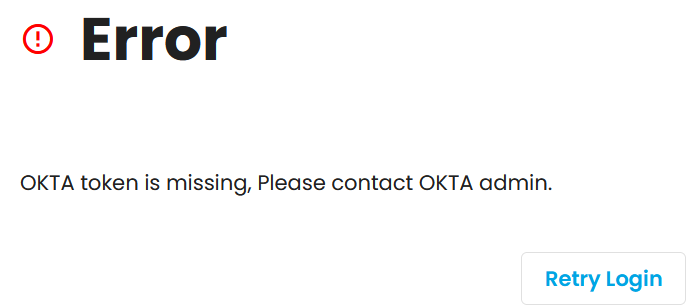

    Hi Richard.
    Is there some other way to access the link you shared? I'm having an issue when I try to follow the link:
    Maybe it's a protected resource. Please your help on this. Thanks in advance.

    Apologies Mauricio. I had mistaken that customers with support access would be able to access the KB article. The key piece of information in the article indicates you can use the following syntax in the partnership to pass binary attributes such as ObjectGUID:
    Assertion Attributes:
    Type: User Attribute
    Value: 'ObjectGUID;binary'
    This assumes you are using ObjectGUID as the sourceAnchor attribute in Azure AD Connect.
