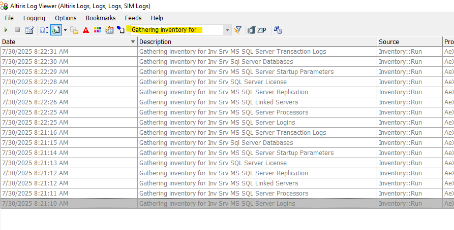

    You should see indications of the inventory in progress - for example:
    Are the other data classes populating?

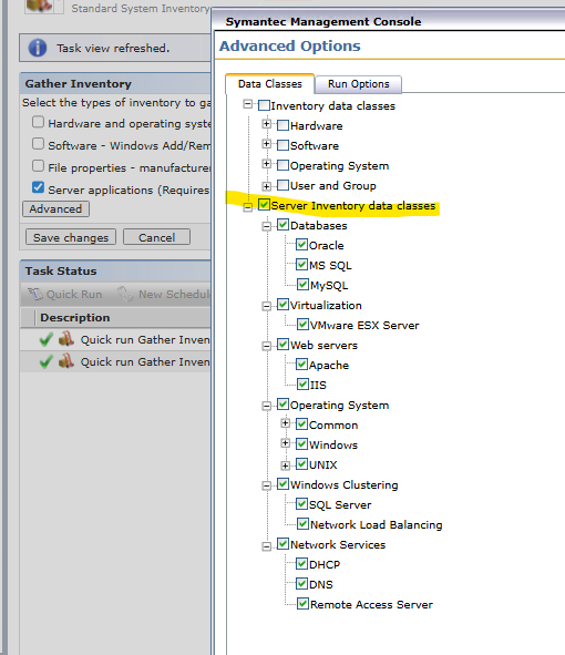

    If you don't find anything helpful, I would recommend opening a support case and to attach verbose/trace logs (be sure to also check the box in the inventory task for full and to log verbose/trace inventory data in Advanced and select all server pack inventory data classes.)  What OS are these servers, and what is the SQL server version? Is this MS SQL?
