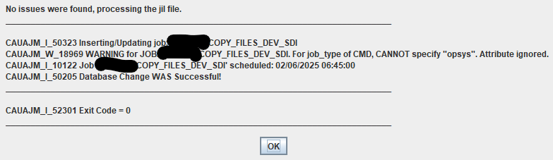

    I am not able to specify opsys: windows as the type of Jobs are CMD (command).
    Any suggestions here? Should the GMSAID have a "$" at the end?

    The attribute opsys: windows cannot be added for "CMD" job types. Any suggestions here?

    Hi Hector, 'opsys: windows' needs to be included in the machine definition of the Windows Agent machine, not in the job.
    In the job definition, the account name in 'owner' needs a $ at the end.

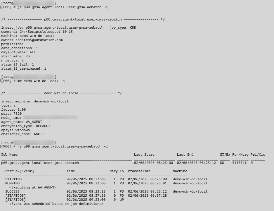

    Hi Hector,
    Antony is correct. Here is a working example, I hope it helps.
    Thanks,
    Jon

    My apologies, I should have made my response clearer. The owner attribute needs to also contain the user domain, e.g., HM07M7R$@company.com
    As you can see from the below example, I was able to reproduce your issue by removing the domain from the working example I provided earlier in this thread:
