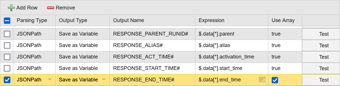

    We use a REST job to check the status of jobs in another AE system, using the GET executions endpoint. In this use case, we are requesting tasks that have completed. We recently discovered that the executions endpoint sometimes includes in the list tasks that are still running (specifically, in status 1574 / Post Processing ).
    The REST job is configured to parse the JSON response and create arrays with the details of the tasks found.
    Tasks in that have not completed lack an end_time element in the JSON response. When one of the JSONPath expression fails to match, the corresponding array will not be created. When the problem happens, only the &RESPONSE_END_TIME# array is not created; all of the other arrays are created. If the task with no end time is first in the JSON response, and followed by completed tasks, the &RESPONSE_END_TIME# array will be created only during parsing of the second result in the list. As a result, the index of this array will be off by one, compared to the other response arrays.
    While we wait for a fix for the REST API bug, is there a good work-around for this? Is there any way to specify that the arrays should be created even if the JSONPath expression does not match, perhaps will a null or empty value inserted as a placeholder for  the missing result?

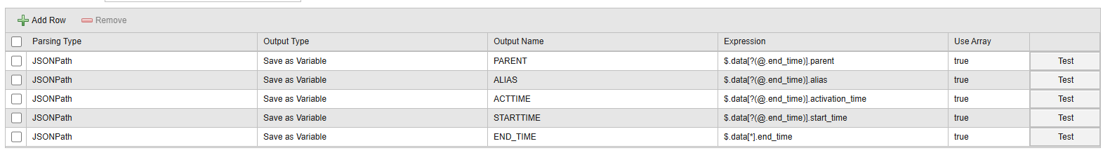

    This can be accomplished with updating the JSON Path Expression.
    by adding a filter for the end_time field to the as a prerequisite to parsing the response data.
    by replacing [*] with [?(@.end_time)] you will only parse results where the end_time element is present. You don't need to update the end_time parsing.
    $.data[?(@.end_time)].parent
    $.data[?(@.end_time)].alias
    $.data[?(@.end_time)].activation_time
    $.data[?(@.end_time)].start_time
    $.data[*].end_time
