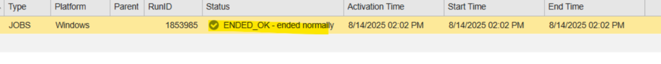

    I am running a stored procedure from my server and executing it via Automic. Basically this stored procedure checks for certain validations and it will return 1 if there is error and 0 if it is successful.
    However, when i trigger it in Automic, it is always showing success in Automic. Is there a way i can programme it to be ENDED_NOT_OK if the stored procedure returns 1?

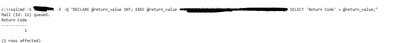

    Hi , i am invoking it through the SQLCMD command
    sqlcmd -S [MyserverName] -E -Q "DECLARE @return_value INT; EXEC @return_value = [My Stored Proc]; SELECT 'Return Code' = @return_value;"
    This is the output from Automic:
