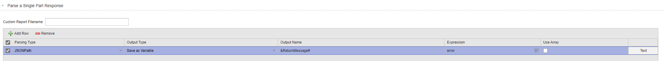

    The response is in json format, but it is not catch with the response part configuration:
    If somebody know how to do, it will be useful for me.

    I think you have to use prep_process_report in Post-Process to do that.
    Responseparsing seems to be for parsing between the Reportline "Start response pattern" and "End response pattern" only.

    there is also an option to map content of the response header to Automic script variables. Unfortunately the "Status" is not part of the response header and therefore I recommend using PREP_PROCESS_REPORT too.
    Regards, Markus
