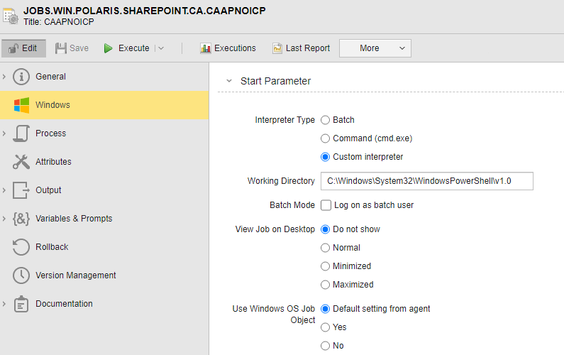

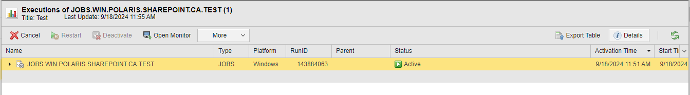

    Hi Team,
    we have an urgent issue, all the Windows jobs having Powershell scripts are not working anymore, even though we can run the script directly in the server PowerShell, it's working perfectly, but when triggering from automic, it's not working anymore. the job gets stuck as active status in AUTOMIC.

    Hi Abhishek,
    Just check whether you setup PowerShell as an interpreter for windows jobs to execute powershell scripts.
    Would you mind to share Agent log file?

    Hi Purneswara,
    we are using PowerShell as an interpreter only.
    Even I have attached the agent's logs for your reference.

    20240918/090826.267 - U02000015 Periodical job test started.
    20240918/090847.465 - U02001020 Cancel job 'JOBS.WIN.POLARIS.SHAREPOINT.CA.CAAPNOICP' with RunID '143879539'.
    20240918/090847.465 - U02001023 Cancel of job 'JOBS.WIN.POLARIS.SHAREPOINT.CA.CAAPNOICP' with RunID '143879539' was successfully initiated.
    20240918/090847.512 - U02000009 Job 'JOBS.WIN.POLARIS.SHAREPOINT.CA.CAAPNOICP' with RunID '143879539' ended with return code '102'.
    20240918/090847.512 - U00063046 Thread '11472' ended with return code '102'.
    20240918/090847.555 - U02001026 Job 'JOBS.WIN.POLARIS.SHAREPOINT.CA.CAAPNOICP' with RunID '143879539' has been removed from the job table.
    20240918/090847.572 - U00029000 Report '143876943' for file 'E:\Automic\Agents\Windows\temp\OAMCWDOL.TXT' has been started.
    20240918/090847.588 - U00029001 Report '143876943' ended normally.
    20240918/090926.453 - U02000015 Periodical job test started.
    20240918/091022.329 - U02000005 Job 'JOBS.WIN.POLARIS.SHAREPOINT.CA.CAAPNOICP' with RunID '143881130' is to be started.
    20240918/091022.392 - U02000003 Job 'JOBS.WIN.POLARIS.SHAREPOINT.CA.CAAPNOICP' started with RunID '143881130'.
    20240918/091022.392 - U02001041 The job was started with Process ID = '9916 (0x26bc)'
    20240918/091022.392 - U02000034 Monitor thread with thread ID '7400' started successfully.
    20240918/091052.560 - U00011439 Cannot log on as user 'pernod-ricard\SRV.AME.POL-AUT'. Error code: '1326 (The user name or password is incorrect.)', error description: ''.
    20240918/091052.560 - U00050014 Cannot open attachment file 'E:\JDEdwards\E920\PrintQueue\R56CPLAP_CA001_93688_PDF.csv', error code: '1326', error description: 'The user name or password is incorrect.'.
    20240918/091053.830 - U00050007 SMTP server 'pernodricard-com01e.mail.protection.outlook.com' has rejected the E-mail recipient: '501 5.1.3 Invalid address [HK3PEPF0000021D.apcprd03.prod.outlook.com 2024-09-18T13:10:53.714Z 08DCD1983F12AB3B]'
    20240918/091056.578 - U00050001 Cannot send e-mail. \E-mail could not be sent because of an error. See previous messages.
    20240918/091056.578 - U02000082 The Agent routine 'UCEXVAR ' needs '34.155' second(s) for message 'SNDMAIL2', RunID '143877720'.
    20240918/091056.578 - U02000015 Periodical job test started.
    20240918/091129.812 - U02000256 Upload of file 'E:\Automic\Agents\Windows\temp\OAMCWFXQ.TXT' started.
    20240918/091129.812 - U02000257 Upload of file 'E:\Automic\Agents\Windows\temp\OAMCWFXQ.TXT' completed successfully.
    20240918/091156.939 - U02000015 Periodical job test started.
     U02001026 Job 'JOBS.WIN.POLARIS.SHAREPOINT.CA.CAAPNOICP' with RunID '143879459' has been removed from the job table.

  • 4.  RE: Powershell script (win job ) stucks in active status
    Posted Sep 18, 2024 11:57 AM
    For your reference, i am attaching the job log report
    ConvertTo-SecureString : The system cannot find the path specified.
    At E:\Automic\Agents\Windows\temp\JAMCWKGL.TXT.ps1:3 char:78
    + ... ic\Test\scriptsencrypted_passwordpolaris.txt | ConvertTo-SecureString
        + CategoryInfo          : InvalidArgument: (:) [ConvertTo-SecureString], CryptographicException
        + FullyQualifiedErrorId : ImportSecureString_InvalidArgument_CryptographicError,Microsoft.PowerShell.Commands.Conv
       ertToSecureStringCommand
    New-Object : Exception calling ".ctor" with "2" argument(s): "Cannot process argument because the value of argument
    "password" is null. Change the value of argument "password" to a non-null value."
    At E:\Automic\Agents\Windows\temp\JAMCWKGL.TXT.ps1:17 char:19
    + ... edentials = New-Object System.Management.Automation.PSCredential($upn ...
        + CategoryInfo          : InvalidOperation: (:) [New-Object], MethodInvocationException
        + FullyQualifiedErrorId : ConstructorInvokedThrowException,Microsoft.PowerShell.Commands.NewObjectCommand
    Add-PnPStoredCredential : Cannot bind argument to parameter 'Username' because it is null.
    At E:\Automic\Agents\Windows\temp\JAMCWKGL.TXT.ps1:25 char:46
    + ... toredCredential -Name $url -Username $appcredentials.UserName -Passwo ...
        + CategoryInfo          : InvalidData: (:) [Add-PnPStoredCredential], ParameterBindingValidationException
        + FullyQualifiedErrorId : ParameterArgumentValidationErrorNullNotAllowed,PnP.PowerShell.Commands.Base.AddStoredCre
       dential
    WARNING:
     You are running the legacy version of PnP PowerShell.
     This version will be archived soon which means that while staying available, no updates or fixes will be released.
     Consider installing the newer prereleased cross-platform version of PnP PowerShell.
     This version has numerous improvements and many more cmdlets available.
     To install the new version:
     Uninstall-Module -Name SharePointPnPPowerShellOnline -AllVersions -Force
     Install-Module -Name PnP.PowerShell
     Read more about the new cross-platform version of PnP PowerShell at
     https://pnp.github.io/powershell
     To hide this message set the environment variable PNPLEGACYMESSAGE to "false"
     In PowerShell add $env:PNPLEGACYMESSAGE='false' to your profile. Alternatively use 'Connect-PnPOnline -Url
     [yoururl] -WarningAction Ignore'
    the job is stuck in Active status only
    Thanks,
    Abhishek
  • 5.  RE: Powershell script (win job ) stucks in active status
    Posted Sep 20, 2024 01:10 AM
    Hi Team,
    Still the jobs stuck in active status, when we try to open the job we are getting the following in the jcl:
    $url="https://pernodricard.sharepoint.com/sites/PRNA-POLARISRoll-Out"
    $password=Get-Content E:\Automic\Test\scriptsencrypted_passwordpolaris.txt | ConvertTo-SecureString
    $upn="SRV.AME.POL-AUT@pernod-ricard.com"

    One more thing when we trying to run the jobs by switching to old agents its running fine , but for the current agent its stuck in active status.
    please help us if anyone aware of the issue.
    Thanks,
    Abhishek
