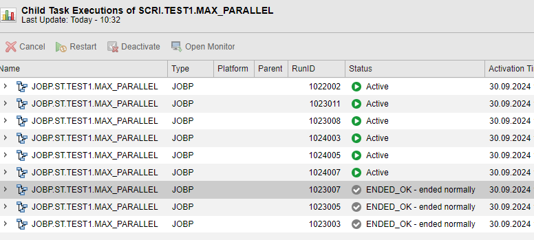

    This bug also exists in V24.2!
    Automic Consultant and Trainer since 2000
    now Tricise

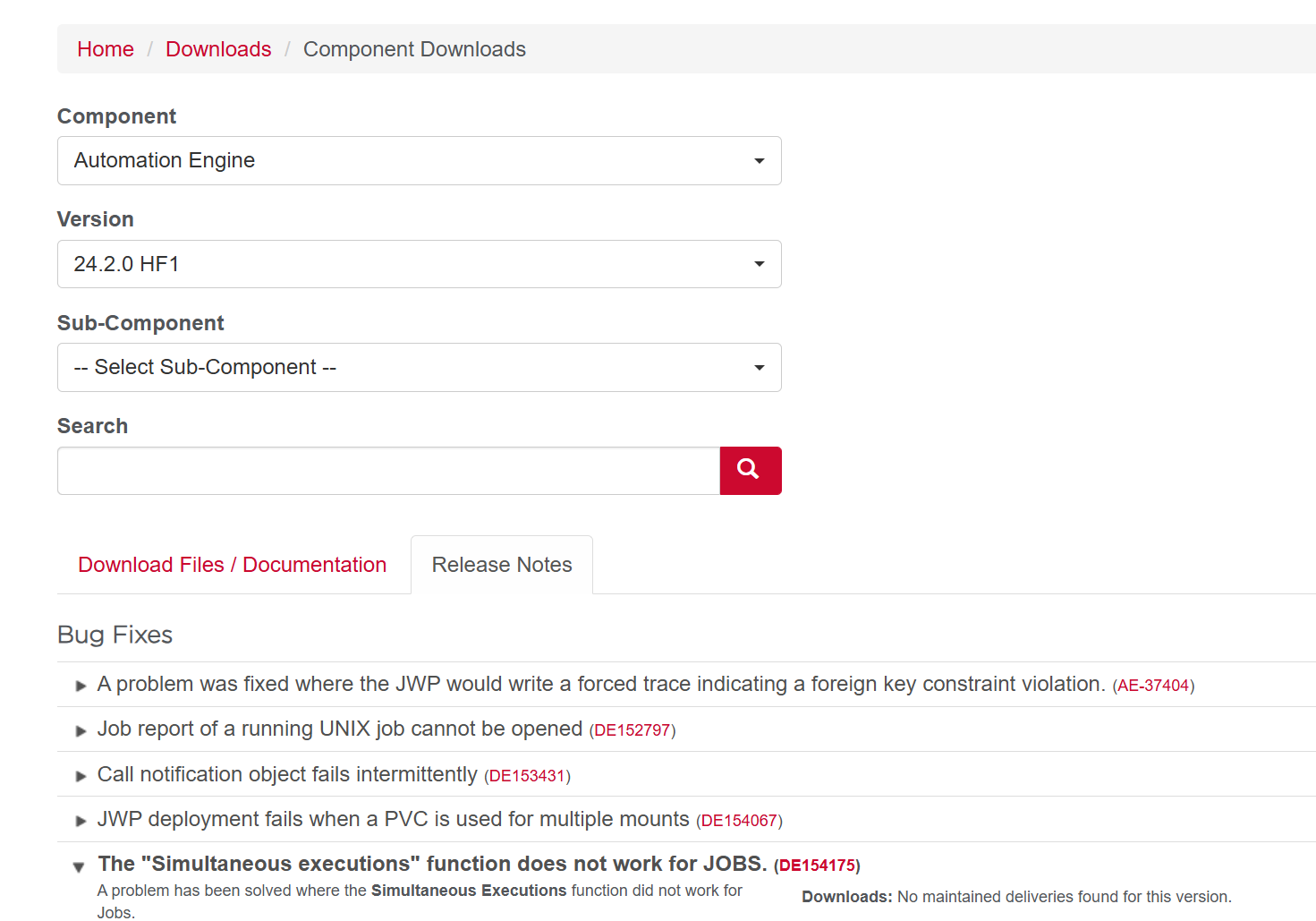

  • 7.  RE: Possible bug in V 21.0.11 (and maybe lower)
    Broadcom Employee
    Posted Oct 28, 2024 05:29 AM
    Hello, this has also been fixed on 24.2.0HF1 on the Automation Engine and it's already available:
    Thanks,
    Adrian
