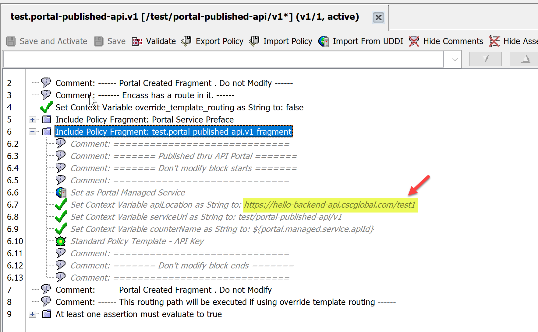

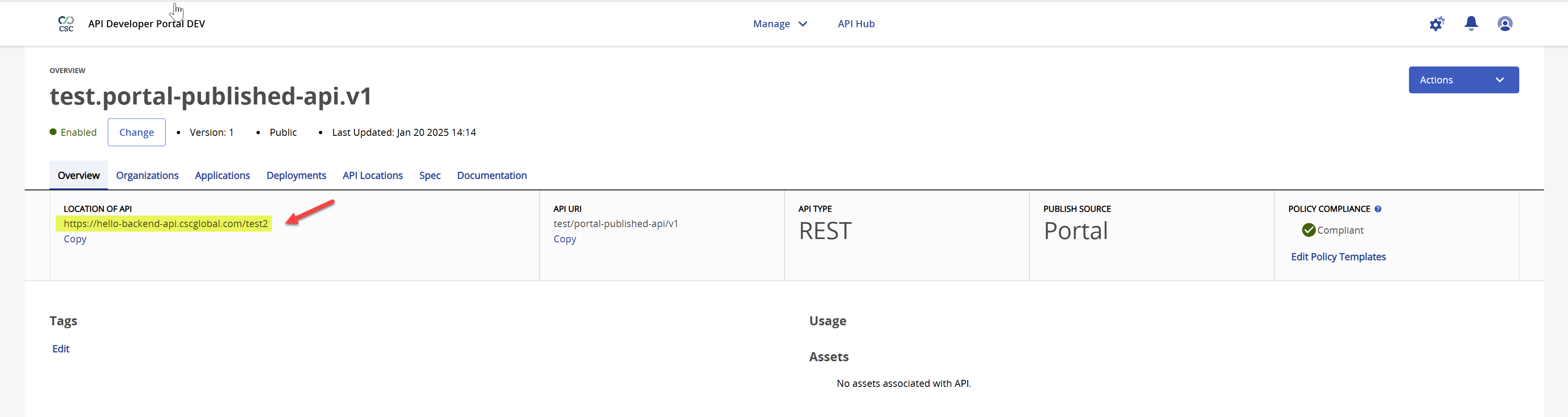

    • Policy on Portal
    • Policy on gateway - As you can see the routing has been updated to /test2 on the Portal side but the Policy on the gateway still shows /test1
    It appears that somehow the changes made in the portal are not being sent to the Gateway. This behavior has been observed in both Portal versions 5.2.3 and 5.3.

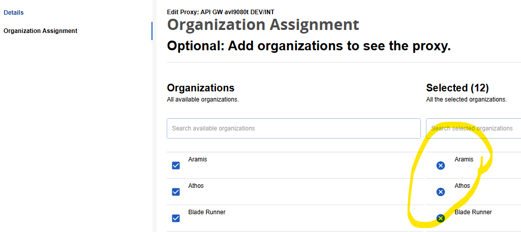

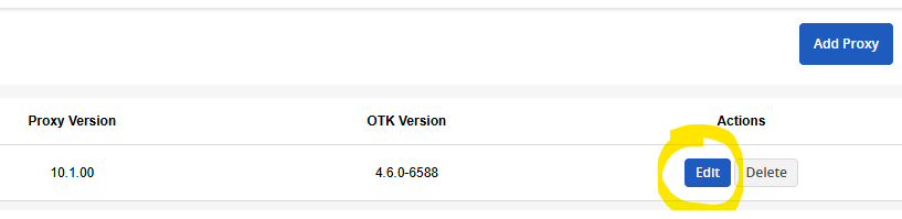

    I had exactly this issue too (with API GW 10.1) and I solved it by going to Edit Proxy
    and there under Organization Assignement select Organization where the user with Org Publisher permissions belong:
    Then Save it and try again.
    Please let me know if it also helped you. Thanks

    Thanks for the quick update. Much appreciated. I did a quick test. looks like its working. Checking more on this.
