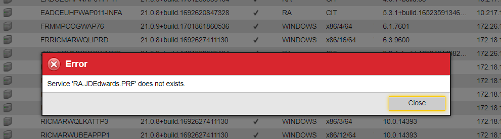

    Hi All,
    We have an issue with JDE agent. When we try to restart JDE agent it went down continuously. We found this below error:-
    Thanks,
    Shubham

    Can you try starting the agent on the OS where it is installed instead of from the AWI? Does it start? Is a log generated?

      |   view attached
    Hi Ian,
    Yes, we tried to restart the agent from agent server also, but it is not coming up. The logs generated as below: -
    20240812/222539.293 - U02000159 Initiate reconnect to the AE system.
    20240812/222539.294 - U02000072 Connection to system 'AUTOMIC' initiated.
    20240812/222539.295 - U02000011 Connection to Server 'FRPRGCOGWAWA01.pernod-ricard.group/10.217.1.36:2217' initiated.
    20240812/222539.296 - U02000012 Connection to Server 'FRPRGCOGWAWA01.pernod-ricard.group:2217' denied.
    20240812/222539.296 - java.net.ConnectException: Connection refused
    20240812/222539.300 - U02000012 Connection to Server 'FRPRGCOGWAWA01:2218' denied.
    20240812/222539.300 - java.net.UnknownHostException: FRPRGCOGWAWA01: FRPRGCOGWAWA01: unknown error
    20240812/222539.301 - Failed to connect to any CP.

    The agent cannot reach the CP. I can see this in the log:
    20240812/222317.931 -           cp=<server name here>:2217
    Firstly, check if there is a CP running on 2217. If so, edit the agent ini and change cp=<ip address>:2217.
    If not, you will need to start a regular CP on port 2217 and 2218
