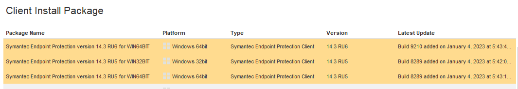

    Posted Jan 20, 2023 09:12 AM
    If you have an on-premises Symantec Endpoint Protection Manager (SEPM), the new clients should have downloaded via the LiveUpdate process and show up in the Install Packages area of the SEPM console.  You can export unmanaged clients from there.
    I found these on our SEPM on January 4, 2023.

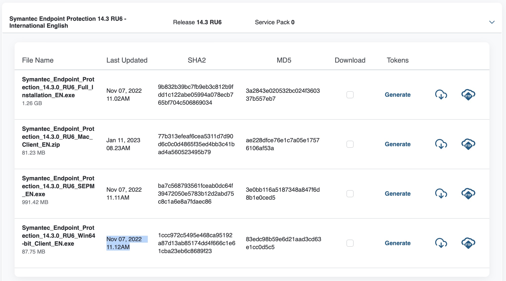

    Posted Jan 20, 2023 02:14 AM
    Hi,
    We are talking about Unmanaged client all this while.
    Mac client is dated Jan 11, 2023 08.23AM
    Windows client is old and dated Nov 07, 2022 11.12AM
    See below screenshot.

    I would also want to know where the new client can be downloaded. It's not available on the download page and our sepm server is connected to the internet but not finding it.
    You can't just drop something like that and then not have a easy way to download and install it on all environments. How hard is to to just add a updated client package for all supported versions on the download page?

    Posted Jan 20, 2023 09:57 AM
    If you have an on-premises SEPM, the new builds should already be downloaded there via LiveUpdate and you can export an unmanaged client.  Once exported, you can take this client to your unmanaged clients and install it on them.
