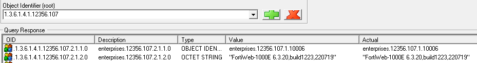

    With snmpget i see that the device not reporting the ha status whit the OID...

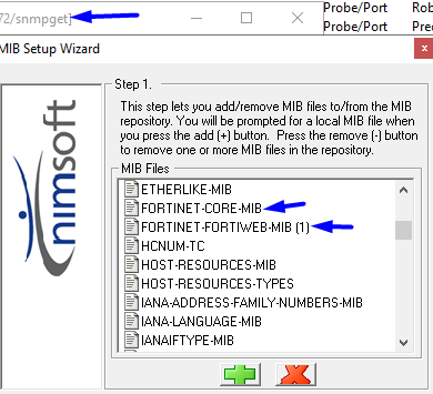

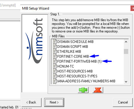

    Yes I loaded the mib in snmptd, in fact configure the OID, only created a profile fo each OID, but i don't see the oid for translation, I added manually.
    I configure this OID's
    How can testing if this OIDs added manually it's working?
    The mibs in snmpget thet was load too...

    Those OIDs are used for traps, so you can use them with snmptd. To test it, you could probably restart the slave.
    You need a different OID for snmpget, one that is used for queries, not for traps.
    For example, fwSysHaMode 1.3.6.1.4.1.12356.107.2.1.3
    High-availability mode HA mode(Standalone, Master, Slave)
    Look for something similar in the Fortiweb MIBs. If you can't find it, you probably can't use snmpget for this.
