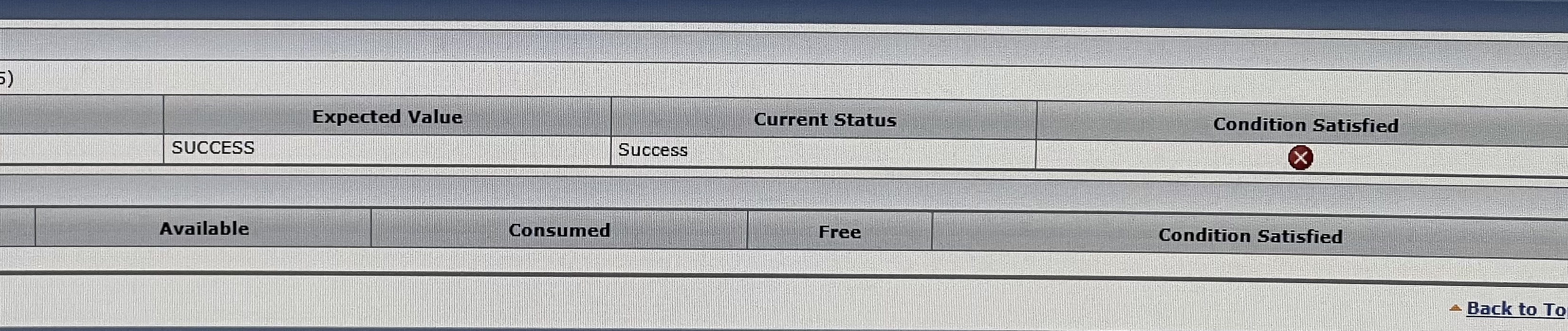

    Hi there,
    FYI,  I am new to autosys.
    I am trying to use success(job_a, 01.00) condition, which I believe according to docs check if job_a is successsfull within the last hour or not right?
    But in autosys workload automation. It is always showing condtion not satisfied. May I know why? Does it depends on any other things. I tested it by manually changing the status of job_a to Success. But in successor job the condition never satisfied.

    My Jobs are somewhat like this.. There may be typo while typing here but just think there are none in my original jobs. When I use s(Job_A,0) It is working fine. Only when I add time it doesn't do what I want.

    Lookback assumes the original job changed its Status sometime BEFORE the conditioned job begins.  If both jobs are in the same box, they both Activate at the same time; there is no "sometime before".  It's similar to having the two jobs floating without a Box; as I mentioned, lookback doesn't do anything useful in that configuration.

    Even if that's the case. My original jobs are in different boxes, the box is running and the Job has success status and the dependent successor job is activated. Still the condition is false. It's not solving the problem.

    Sagar, you should try a proper test:
    1. Make sure Job_Box1 and Job_A have not run in the past hour
    2. Force-start Job_Box2
    3. Job_B should be Activated but not be Running, since there's been no change of Status to Job_A in the past hour
    4. Kill Job_Box2.  Neither Job_Box2 or Job_B should be Activated or Running.
    5. Force-start Job_Box1.  Job_A should get a new Success status.
    6. Wait for a few minutes
    7. Force-start Job_Box2.  Job_B should be Running or already be Success, since Job_A had a change to Success in the past hour.

    I think it would be really good to review the information in regards to Box Logic;  when to use a box vs when not to.  Also, seems this is inside of a box and your condition on Job_B is with the run_window  the lookback of an hour is never really going to work most of the time due to you having it running 45 minutes after job A has ran --  your window is really only open for 15 minutes from the logic in the JIL that I am looking at.   If you look at some of the older versions of AutoSys and look up information on Box Logic I think it will be of great help.

    Is there any reason to have a box here? I would remove the box. I think you might be able to remove the schedule from job b too, adding another condition that it is to run when job a is done.

    Is your successor job, say job_b, Activated?  If job_b is sitting in a Box and that Box not Running, then job_b would be ignored by AutoSys, regardless of any new status of job_a.
    Let's say job_b is floating and not in any Box.  In that case job_b is Activated by default, unless it's already in one of the Running statuses.  To test, set job_b's status to Inactive (it's really Activated).  Then set job_a's status to Success (it could already be Success, but this will be a new Success).  You should find job_b's status has changed to Running or a completion status (Success, Failure, etc.).
    Note that in the case of floating jobs, lookback doesn't really change anything.  You could set it to 01.00, 0, or not include a lookback parameter; it will act the same.  If job_b is in a Box, then the lookback timing comes into play depending on when job_a went Success and when the Box containing job_b is Run sometime afterwards.
