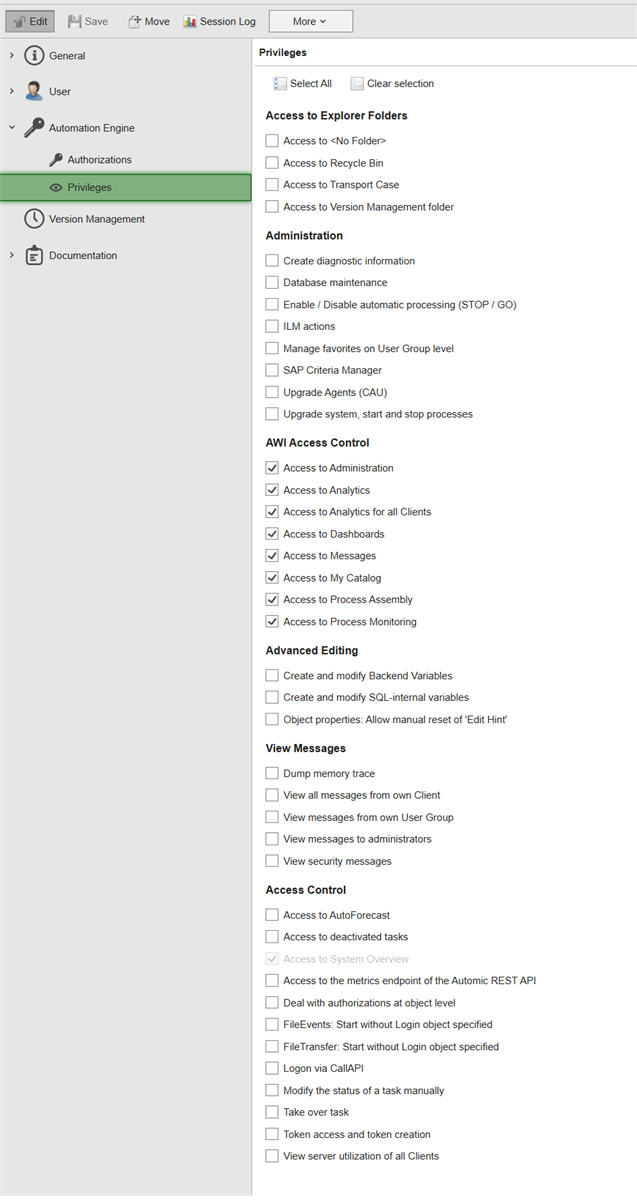

    Hello.  I've tracked this down to additional required permissions for V24.  The ldap user will need the following minimum permissions, including access to Analytics.  I'm assuming this is a change in how the system overview is permissioned internally.
