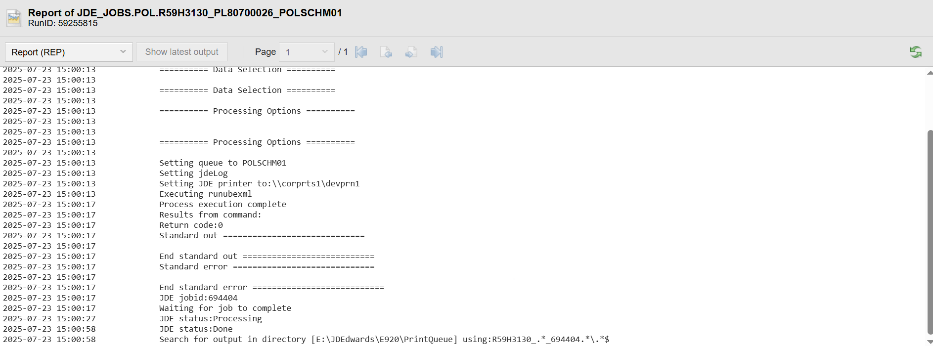

    We are currently facing an issue with one of the JDE jobs. The job has successfully completed in JDE; however, in Automic, it continues to show as active.
    We have already reviewed the job, workflow, and agent logs but were unable to identify the root cause.
    Log report.
    We encountered similar behavior with other JDE jobs earlier this week.
    Kindly assist us in investigating this issue. Please let us know if you require any additional information from our end.
