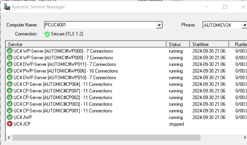

    Within a v12.3 to v24 update project,
    we have the following error when booting the system, since the JCP processes come down.
    (see attached screenshot and logs)
    Thank you very much in advance
    Regards
    Santiago Fernández

  • 2.  RE: JCP processes fall
    Posted Oct 01, 2024 05:04 AM
    Hi Santiago,
    the log and traces provided are from a REST API process, not a JCP.
    Nevertheless, the log shows an error when binding the port number 8088
    regards,
    Peter

  • 3.  RE: JCP processes fall
    Posted Oct 01, 2024 05:15 AM
    Hi Santiago,
    the log of the REST API process shows a bind error:
    Exception 'java.io.IOException: "Failed to bind to 0.0.0.0/0.0.0.0:8088"' at 'org.eclipse.jetty.server.ServerConnector.openAcceptChannel():344'.
    The previous error was caused by 'java.net.BindException: "Address already in use: bind"' at 'sun.nio.ch.Net.bind0()'.
    It seems that port 8088 is already in use by another program. You now have 2 options:
    1. kill the running process that currently uses 8088 and afterwards start the new Rest API process
    2. configure a different port number (i.e. 8089)
    BTW: the ServiceManager Dialog is not showing a Rest API line ...
    regards,
    Peter
    Automic Certified Professional/Expert & Broadcom Knight
    For AUTOMIC trainings please check https://www.qskills.de/qs/workshops/automic/
  • 4.  RE: JCP processes fall
    Broadcom Employee
    Posted Oct 01, 2024 05:21 AM
    Hi @Santiago Fernandez
    be aware that v24.x (and already v21) has 5 different process types. They are named CP, WP, JCP, JWP and REST. You need at minimum 1 of each.
    see https://docs.automic.com/documentation/webhelp/english/AA/24.2/DOCU/24.2/Automic%20Automation%20Guides/Content/_Common/Welcome/AWA/AWAArchitecture.htm?tocpath=Welcome%7C_____3
    This page gives an overview on how to setup/configure these process types:
    https://docs.automic.com/documentation/webhelp/english/AA/24.2/DOCU/24.2/Automic%20Automation%20Guides/Content/Installation_Manual/AE/InstalltheAE_ServerManager_JWP_JCP.htm?tocpath=Installing%7CManual%20Installation%7CInstalling%20the%20Automation%20Engine%20(AE)%7CInstalling%20the%20AE%252C%20ServiceManager%252C%20JWP%252C%20REST%20and%20JCP%7C_____0
    Michael

  • 6.  RE: JCP processes fall
    Best Answer
    Broadcom Employee
    Posted Oct 02, 2024 03:53 AM
    Edited by Santiago Fernandez Oct 03, 2024 03:31 AM
    Hi Santiago,
    it looks like you are trying to start multiple REST processes using the same port. One REST process per Node is normally sufficient. Start multiple JCPs instead. Is there a specific reason you are still keeping CP processes?
    Regards, Markus
  • 7.  RE: JCP processes fall
    Posted Oct 03, 2024 03:39 AM
    Thank you all for your collaboration. We already have all the different types of processes in green.
    It was a certificate problem, by deleting a REST that was launched and adjusting the certificate again, it was solved. As Markus pointed out, only one was necessary. Thank you all very much
