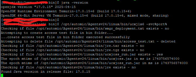

    host bash_profile = java 11 , external path java 17
    if we set java 17 path on bash_profile . succesfully up .  As we understand here, it seems that we need to give the java 17 path to bash_profile. right?

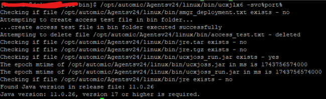

    classic approach : /opt/automic/Agentsv24/linux/bin/ucxjlx6 -svc%port%
    java approach : java -jar /opt/automic/Agentsv24/linux/bin/ucxjoss.jar  ( edit: there is no for type of approach)
    my question is : Is java 17 mandatory in the classical approach? If so, is bash_profile java_home mandatory on classical approach ?
    as you can see in the screenshot above, if you do not specify java 17 java_home in the bash_profile, the agent does not start when you up with executable ucxjlx6 (classic approach) .  is java 17 mandatory for classic approach executable ucxjlx6 ( not ucxjoss.jar)  ?
    there are some servers where old java 11 is used as bash_profile java_home. in these case , we cannot set java 17 in bash_profile. when I set java 17 path as a parameter from the outside on classic approach. it didn't turn up that way either. that's why i ask :)

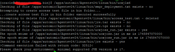

    I tried like this. but same error. should I also find jre for openjdk 17 from outside ?  or is there anything missing from your point of view?
    >Command execution failed with return code: 32512<
    Please check your environment, minimal supported JVM version is 17.

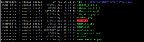

    Link Command:
    ln -s /apps/automic/java/java17/bin      /apps/automic/Agentsv24/linux/bin/jre
    Agent bin folder:
    cannot find java 17 :

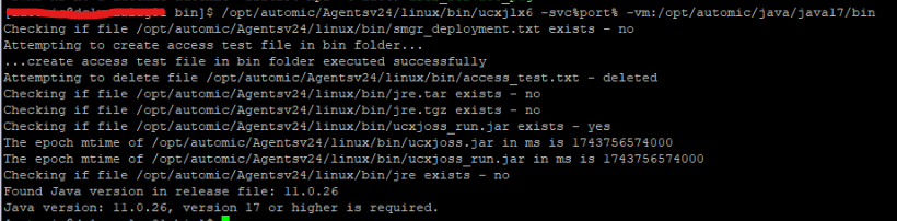

    With the latest service pack of the Agent a new command-line option was introduced which allows to specify the path to the used Java VM.
    e.g.
    ./ucxjlx6 -vm:/lib/jvm/java-17-openjdk
    or
    .\ucxjwx6.exe -vm:"C:\Program Files\Eclipse Adoptium\jdk-21.0.x.y-zzz"
