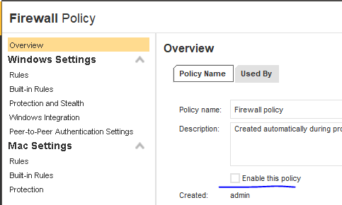

    Findings 1
    At first, I fully disabled the Firewall Policy based on the same screenshot you shared.
    As a result, users can browse Internet normally without any interruption.
    Findings 2
    Based on the traffic log, I discovered the interruption was blocked by the default rules – Rules 30. By unchecked rules 30. User can browse Internet normally.
