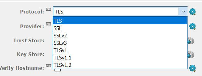

    MQ Infrastructure is using mTLS for all clients and now DevTest needs to connect to MQ infra with mTLS.
    MQ team has provided the certificate from their side and I do have LISA cert as well.  However I am not able to see mTLS option in the protocol option for connectivity and not sure where to use lisa cert for hand shake.
    Can we support mTLS. please suggest. thank you.

    Posted Jul 08, 2025 07:20 AM
    HI Vinay
             The existing protocols that are part of the SSL Context have the ability to provide a keystore. You could configure a client certificate using a keystore using any of the available protocols and check if Mutual TLS works fine. If there are any issues, we are happy to help.

    Thank you Sankar. I provided DevTest cert to MQ team and they have configured the devTest cert.
    I just wanted to understand If I need to also add DevTest cert in MQ configs in order to connect to Queue Manager. Currently I am seeing an error below mentioned.
    Error: Error opening queue manager IBMMQMGR, Completion Code 2 (MQCC_FAILED), Reason Code 2397 (MQRC_JSSE_ERROR)

    HI Vinay
    PLease open a support case. We will look into it and help you solve
    this problem. This JSSE error typically means mismatch in cipher spec
    configuration between Client and Server.

    Posted Jul 08, 2025 08:56 AM
    HI Vinay
    [image: image.png]
