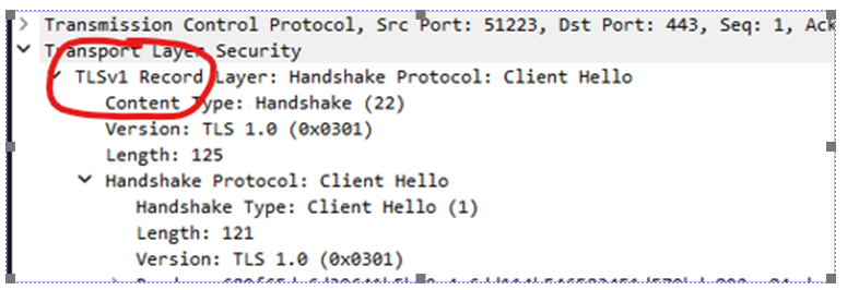

    We are trying to initiate a TLS 1.2 connection to an external vendor from a GUI client and are failing.  The wireshark trace indicates that we are sending a TLS 1.0 HELLO.  How can we specify TLS 1.2 instead?  The interface is provided by a .COM DLL provided by the vendor.

    from the trace:
    From your screenshot, this stands out to me.
    TLS v1 is not usually supported in newer applications
