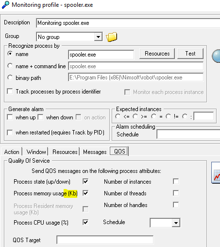

    I need to capture the usage percentage of some processes, I know that the process probe could meet this requirement, but in kb, and I need the percentage.
    Any idea ?

    Hi Miller,
    The processes probe uses Windows WMI to obtain process performance details. I've done some research and it looks like the WMI does not provide the predefined class for the Process Memory in %, instead, the working set is the used.
    The way the task manager displays the percentage information is a simple calculation:
    percentage of a process = (current private working set of a process/ sum of all processes' private working set) * current total memory usage percentage.
    That is why I believe the Percentage value is not available in the Processes probe. However, I think this is a valid use case, and I would recommend raising an enhancement request on our ideation portal. The article below will guide you through the process
    https://knowledge.broadcom.com/external/article/12135/how-to-raise-an-enhancement-request-for.html
    There are potentially some alternative ways of achieving the goal, like collecting the processes working sets and total working set (using logmon), then doing similar calculations using Lua scripts or NAS preprocessing rules, however, that would be an advanced and strong customization, and I do not think that's the valid and optimal method.
    Let me know if you have further questions.
