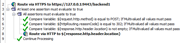

    You're likely having a problem with the HTTP route assertions Follow Redirects behavior. It will only follow redirects when the request method is GET. It will not follow redirects when the request method is POST like in your example. However, you can handle the latter in policy. Here's a very basic example.
    I have two backends, Backend 1 and Backend 2, and a service, FollowRedirect, that will be redirected from one (i.e. Backend 1) to the other (i.e. Backend 2):
    The FollowRedirect service policy looks like so:

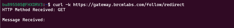

    If I make a curl request to the service with a GET (i.e. no data which would turn it into a POST), then the first route assertion handles the redirect from Backend 1 to Backend 2 and here is the response I get back from Backend 2:

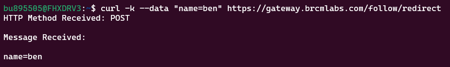

    If I make a curl request to the service with a POST (i.e. by sending data), then the first route assertion does not handle the redirect from Backend 1 to Backend 2, and the subsequent policy detects this a posts the original request to the redirect location.  Here is the response I get back from Backend 2:

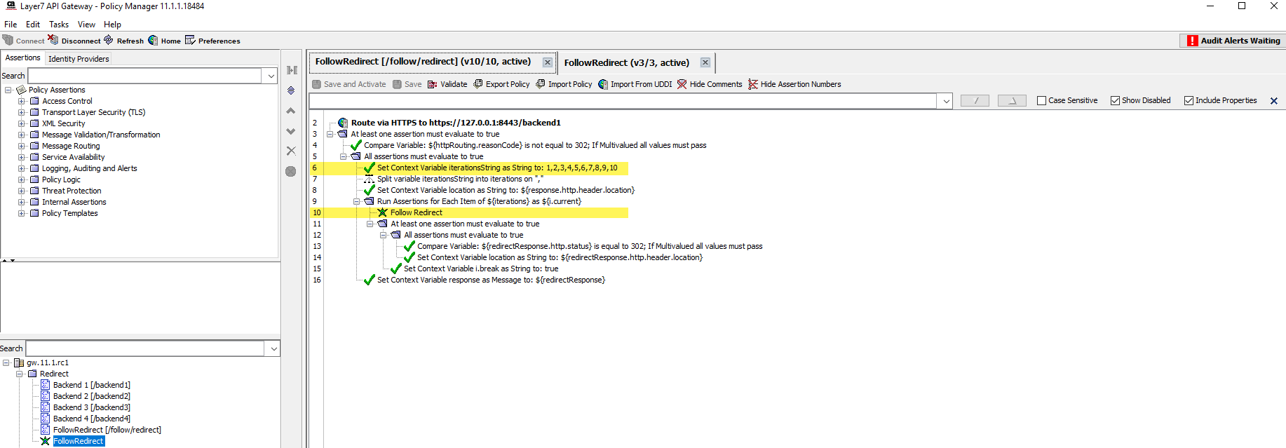

    Here is another basic example that uses looping to efficiently handle multiple redirects with an upper limit that you can control (attached as a Graphman bundle, redirect-example-bundle.json, that can be imported to a test gateway using Graphman). It includes the contents of the Redirect folder, including the FollowRedirect encapsulated assertion.
    The test API controls the upper limit of the for each loop on line 6, and calls the FollowRedirect encapsulated assertion on line 10:

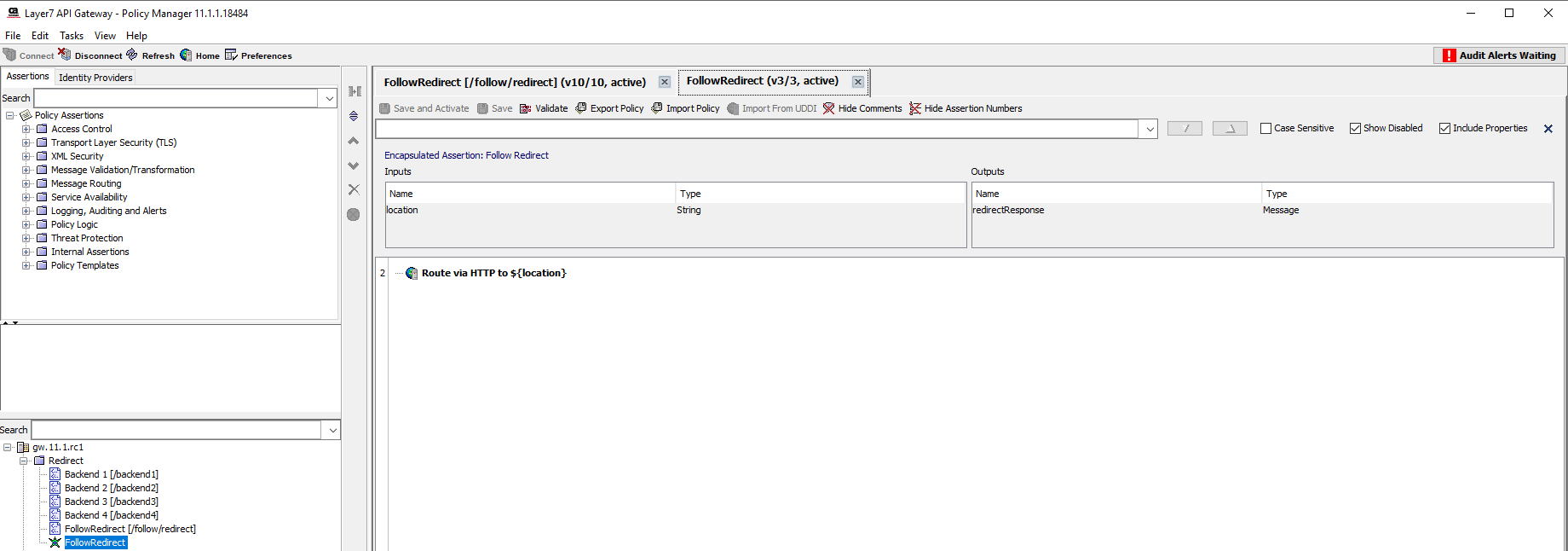

    The FollowRedirect encapsulated assertion is very simple and is only used to provide some response message isolation to avoid current limitations with writing to an existing response message inside of a loop in policy:
    You will likely need to add additional policy to propagate headers and cookies as might be necessary for you use case.
