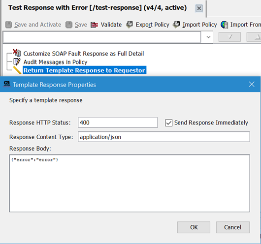

    I've just published 2 more service to test.
    • First one routes the request to the second and returns response with ${response.mainpart}
    • Second one just returns response;
    Then I started debugger on both service and sent request to the first one. As you see below there is no response message;
    And by the way, the second service sent response message;
    When I changed the the response status to 200 on second service it works OK,
    Thanks again.

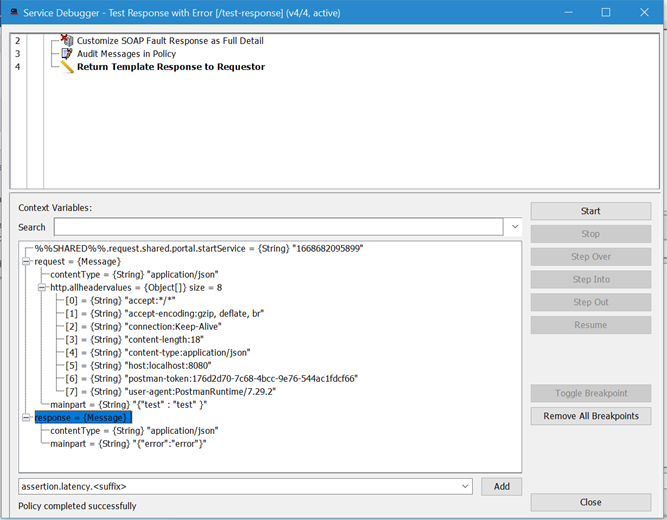

    I have seen cases where a variable is not visible in the debug window when it is not used explicitly. In your examples you have demonstrated both situations, which is perfect. Could you please try to set a context variable in both cases after routing assertion as tmp = ${response.mainpart} and debug again?
    Or you can add the response variable to watch by typing "response" and pressing the "add" button.

    Posted Nov 17, 2022 02:08 AM
    Hi Ozgur,
    Try to add the response variable during the debug as shown below. Or create a temporary variable and assign ${response.mainpart} after the routing assertion.
