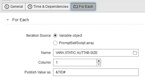

    Yes you can. You define the variable in which the VARA-key is stored for each iteration on the start task. By default this is &ITEM# which seems to be stored as an object variable for every iteration and is therefore inherited to the child tasks if they accept it.
    When you have a workflow task with a promptset within the FE workflow, just use &ITEM# as default value for the input-field. Alternatively, you can use the syntax {[VARA], [KEY], [INDEX]} for gathering another value-field of the iteration source VARA.

    That's right. Below is an example:
    The child tasks of the For-Each flow can use/refer the above variable set here and it is not the otherway.
