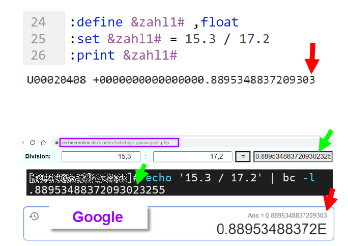

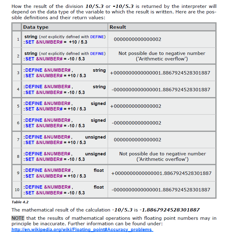

    This is what I wrote several years back:
    And further:
    Cheers
