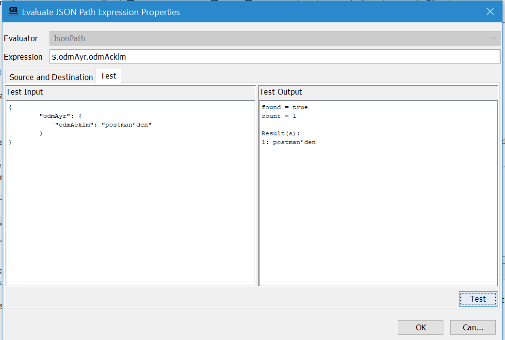

    I have an issue about evaluate JSON Path Expression Assertion when the message includes ' character.
    Sometimes it changes the ' character to \u2019
    I've  added the sample request text file and two different screenshots about the issue.
    At the first one it works OK,
    The wrong result on the second one,
    Do you have any suggestion to fix that?

    You are returning two very different things in your screenshots.
    In the first screenshot you are asking for a value, in the second screenshot you are asking it to return a JSON Object.  It looks like the gateway is automatically decoding when you return a value, but not when you return an object.  I am not sure if that's a result of policy manager supporting unicode, or an extra step taken by the assertion to decode values.
    The "right single quotation mark" is a unicode symbol, JSON uses UTF-8, so it has to encode the UTF-16 value. I suspect you pasted in your test input from MS Word, or some other pretty-print text editor?  If you replaced the "right single quotation mark" with its simple ASCII apostrophe (') equivalent , does it work?

    Hi Joseph,
    Yes, the situation is exactly as you described.
    I actually noticed this issue when we saw an unexpected message in the backend. Afterwards, when I examined the logs on layer7, I saw that the right single quotation mark in the request was causing the problem.
    It seems that the other institution's mobile application uses the right single quotation mark instead of apostrophe.
    I didn't encounter any issues for ASCII apostrophe when I tested it. However, since the application does not belong to us, we cannot recommend it as a solution.
    I guess the only solution in this case is to replace the right single quotation mark with apostrophe in the request with Evaluate Regular Expression Assertion, right?
