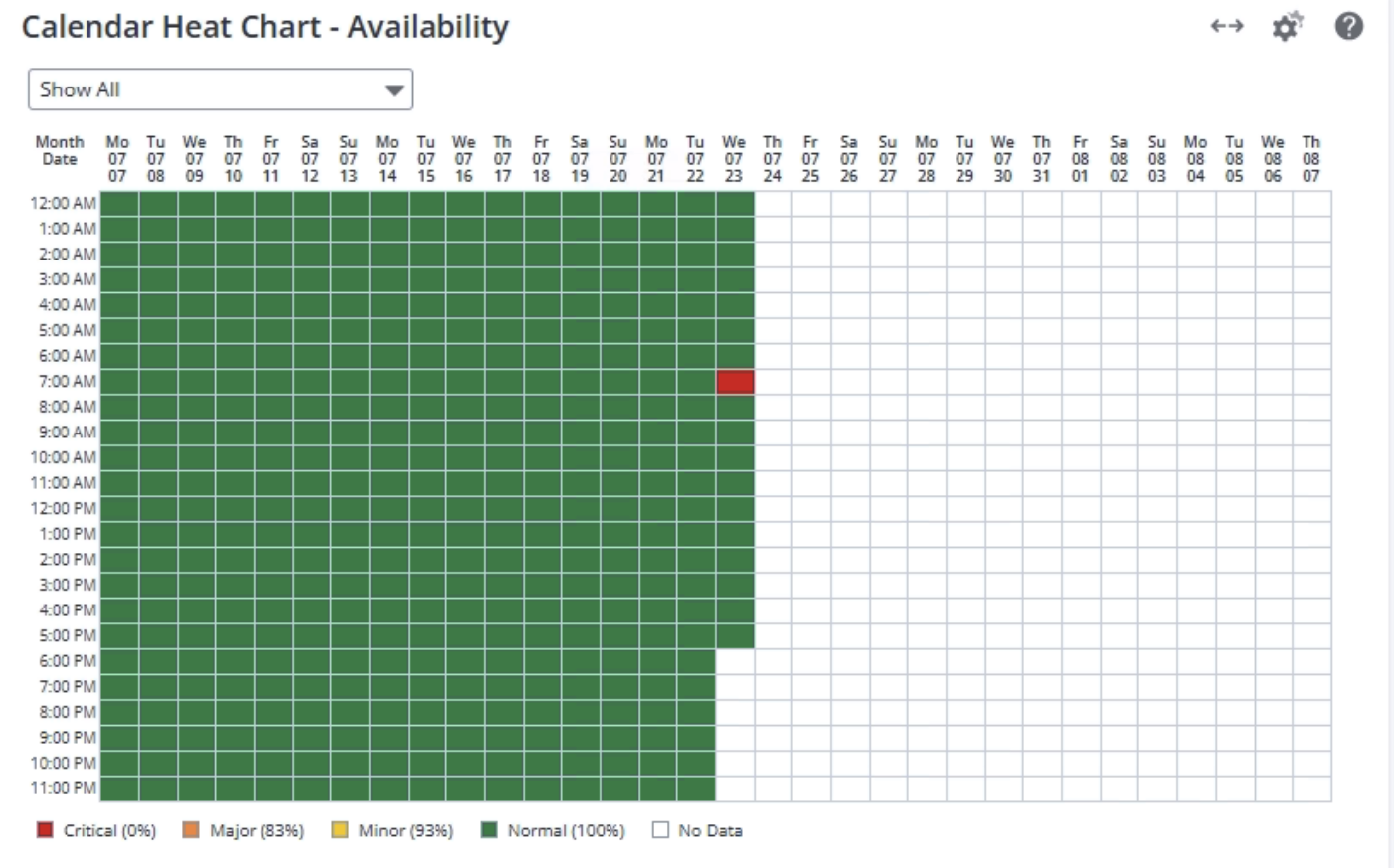

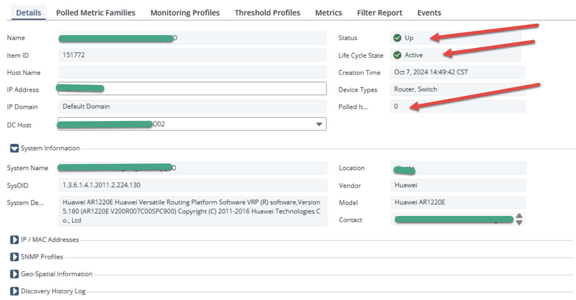

    I want to know if any of you have experienced that when you change the device's life cycle, it stops recording data even though its status is correct.
    I'm sharing some images of the device.
    The device show correct status, but no show stadistics since July 23
    If anyone knows what is wrong or how I can fix it
    I'd appreciate it.

  • 2.  RE: Device no work after the change LifeCycle at DX PM.
    Posted Aug 08, 2025 01:27 PM
    When you stop and restart life cycle, it probably creates a new device.
    Set the view to show most recent data, then check to see if deviceID has
    changed .

  • 3.  RE: Device no work after the change LifeCycle at DX PM.
    Broadcom Employee
    Posted Aug 11, 2025 12:58 PM
    When you say you changed it's lifecycle, what value did you change it to?
    Active->Maint or Retired?   Both tell the DA to stop polling the device.
    And did you change it back to Active?  That tells the DA to start polling the device.
    But if you changed from Retired->Active, it might have created a new DA device while old DA device was Retired.
    Portal should not have allowed you to activate a retired device if same IP has active device.
    But you can check DA Monitored Devices to see if there is more than one device with that name or IP.
    Worst case, you can try doing stop polling on Monitored Devices and then wait 1-2 mins, than start polling, and see if in 10 mins, it returns data?

      |   view attached
    Hello Jefffrey and David,
    I've reviewed the device events and don't see that the device has been set to "RETIRED," although if there were changes to the device, they're shared.
    I've checked the Vertica database and verified that the device wasn't created with a different ID. The answer is that I didn't find anything duplicated by name or ID. I'm sharing the query output.
    drdata=> SELECT * FROM dauser.dim_item WHERE item_id='151772';
     is_device | device_item_id | global_device_item_id | item_id | global_item_id | item_create_time | item_description | item_display_description | item_display_name |            item_name            | device_description | device_display_description | device_display_name | device_name |       item_alternate_name       | retired_timestamp | is_polled | is_poll_enabled | ip_domain_id | device_discovery_profile_id | device_elevation | device_hostname | device_latitude | device_location_description | device_longitude | device_primary_ip | device_supported_protocols | device_supports_on_demand_mf_discovery | device_lifecycle_state | device_location |                                                                         device_system_description                                                                          |       device_system_name        | device_change_detection_disabled_mfs | device_polled_item_count | port_admin_status | port_alias | port_ip_addresses | port_mac_address | port_oper_status | port_speed_in | port_speed_out | port_type | component_monitoring_profile | high_layer_left_id | high_layer_right_id | low_layer_left_id | low_layer_right_id | sla_path_class_id | sla_path_path_id | sla_class_latency | sla_class_pkt_loss_pct | sla_class_jitter | vna_desc | aggregated_type | partition_column |        insert_time
     t         |         151772 |                 13224 |  151772 |          13224 |    1728334182569 |                  |                          |                   | SENP-D-OTR112263_IPN_CICATA_QRO |                    |                            |                     |             | SENP-D-OTR112263_IPN_CICATA_QRO |                   | t         | t               |            2 |                     1792692 |                  |                 |                 |                             |                  | 10.72.234.68      | ICMP,SNMP                  |                                      1 | ACTIVE                 | cliente         | Huawei AR1220E Huawei Versatile Routing Platform Software  VRP (R) software,Version 5.160 (AR1220E V200R007C00SPC900) Copyright (C) 2011-2016 Huawei Technologies Co., Ltd | SENP-D-OTR112263_IPN_CICATA_QRO |                                      |                       19 |                   |            |                   |                  |                  |               |                |           |                              |             151772 |              151772 |                   |                    |                   |                  |                   |                        |                  |          |                 |                1 | 2025-08-19 11:17:27.063481
    (1 row)
    drdata=> SELECT * FROM dauser.dim_item WHERE item_name='SENP-D-OTR112263_IPN_CICATA_QRO';
    (1 row)
    drdata=> SELECT * FROM dauser.nrm_cpustats_rate WHERE item_id='1076300' LIMIT 1;
     dcm_id | pollgroup_id | item_id | rollup_type |   tstamp   | rinterval | duration | thresh_duration | thresh_count | dto_sequence_id | im_cpuniceutilization | im_pctcpuspentrunningirqproc | min_im_pctcpuspentrunningirqproc | max_im_pctcpuspentrunningirqproc | std_im_pctcpuspentrunningirqproc | cv_im_pctcpuspentrunningirqproc | pct_im_pctcpuspentrunningirqproc | im_cpuidleutilization | im_averageutilizationforcontrolcpus | im_cpustatsentitledcapacity | min_im_cpustatsentitledcapacity | max_im_cpustatsentitledcapacity | im_cpuutilizationlasthour | im_syscpuloadlast5minutes | min_im_syscpuloadlast5minutes | max_im_syscpuloadlast5minutes | std_im_syscpuloadlast5minutes | cv_im_syscpuloadlast5minutes | pct_im_syscpuloadlast5minutes | im_cpubusypercinlastcpmcpumoninterval | im_pctcurrentflowsession | im_cpusoftwareinterruptsutilization | im_ttlmemorydedicatedcpu | im_syscpuloadlastminute | min_im_syscpuloadlastminute | max_im_syscpuloadlastminute | std_im_syscpuloadlastminute | cv_im_syscpuloadlastminute | pct_im_syscpuloadlastminute | im_ttlmemoryconsumedbymemorycacheoncpu | im_cpuhardwareinterruptsutilization | im_cpubusypercininterruptcpmcpumoninterval | im_cpustatsprocessorsconsumed | min_im_cpustatsprocessorsconsumed | max_im_cpustatsprocessorsconsumed | im_memoryutilization | min_im_memoryutilization | max_im_memoryutilization | std_im_memoryutilization | cv_im_memoryutilization | pct_im_memoryutilization | im_currentcpsession | im_averageutilizationfordatacpus | im_cpuuserutilization | im_utilization | min_im_utilization | max_im_utilization | std_im_utilization | cv_im_utilization | pct_im_utilization | im_cpuusagemonitoringinterval | im_pctcurrentcpsession | im_statuscode | im_cpusystemutilization | im_status | im_currentflowsession | im_syscpuloadlast15minutes | min_im_syscpuloadlast15minutes | max_im_syscpuloadlast15minutes | std_im_syscpuloadlast15minutes | cv_im_syscpuloadlast15minutes | pct_im_syscpuloadlast15minutes | im_ttlmemoryconsumedcpu | im_cpuutilizationaverage5seconds | im_numberofcpucores | im_ttlnumprocessescpu | im_pctcpuspentrunningioproc | min_im_pctcpuspentrunningioproc | max_im_pctcpuspentrunningioproc | std_im_pctcpuspentrunningioproc | cv_im_pctcpuspentrunningioproc | pct_im_pctcpuspentrunningioproc | im_applicationcpuutilization | min_im_applicationcpuutilization | max_im_applicationcpuutilization | std_im_applicationcpuutilization | cv_im_applicationcpuutilization | pct_im_applicationcpuutilization | im_pctcpuutilizationperprocess | min_im_pctcpuutilizationperprocess | max_im_pctcpuutilizationperprocess | std_im_pctcpuutilizationperprocess | cv_im_pctcpuutilizationperprocess | pct_im_pctcpuutilizationperprocess | im_cpuutilizationlastmin | im_cpuwaitutilization | im_numberofcpus
       6971 |         5520 | 1076300 |           0 | 1748390400 |       300 |      300 |               0 |            0 |         1940423 |                       |                              |                                  |                                  |                                0 |                                 |                                  |                       |                                     |                             |                                 |                                 |                           |                           |                               |                               |                             0 |                              |                               |                                       |                          |                                     |                          |                         |                             |                             |                           0 |                            |                             |                                        |                                     |                                            |                               |                                   |                                   |                      |                          |                          |                        0 |                         |                          |                     |                                  |                       |              8 |                    |                    |                  0 |                   |                    |                               |                        |               |                         |           |                       |                            |                                |                                |                              0 |                               |                                |                         |                                  |                     |                       |                             |                                 |                                 |                               0 |                                |                                 |                              |                                  |                                  |                                0 |                                 |                                  |                                |                                    |                                    |                                  0 |                                   |                                    |                          |                       |
    (1 row)
    drdata=> SELECT * FROM dauser.nrm_cpustats_rate WHERE item_id='1076300' ORDER BY tstamp DESC LIMIT 1;
       6971 |         5520 | 1076300 |           0 | 1753311300 |       300 |      300 |               0 |            0 |         2428263 |                       |                              |                                  |                                  |                                0 |                                 |                                  |                       |                                     |                             |                                 |                                 |                           |                           |                               |                               |                             0 |                              |                               |                                       |                          |                                     |                          |                         |                             |                             |                           0 |                            |                             |                                        |                                     |                                            |                               |                                   |                                   |                      |                          |                          |                        0 |                         |                          |                     |                                  |                       |              9 |                    |                    |                  0 |                   |                    |                               |                        |               |                         |           |                       |                            |                                |                                |                              0 |                               |                                |                         |                                  |                     |                       |                             |                                 |                                 |                               0 |                                |                                 |                              |                                  |                                  |                                0 |                                 |                                  |                                |                                    |                                    |                                  0 |                                   |                                    |                          |                       |
    (1 row)
    drdata=> SELECT * FROM dauser.ifstats_rate WHERE item_id='1076339' ORDER BY tstamp DESC LIMIT 1;
     dcm_id | pollgroup_id | item_id | rollup_type |   tstamp   | rinterval | duration | thresh_duration | thresh_count | dto_sequence_id | im_ipsecencodingfailures | im_sapolicydenialpacketsdropped | im_framesout | std_im_framesout | cv_im_framesout | im_bytes | im_pctdiscardsin | min_im_pctdiscardsin | max_im_pctdiscardsin | std_im_pctdiscardsin | cv_im_pctdiscardsin | im_frameerrors | im_discards | max_im_discards | std_im_discards | cv_im_discards | im_avginboundoctetrateforinterface | im_cellerrorratio | im_noassocsapolicypacketsdropped | im_avgoutboundoctetrateforinterface | im_framesizein | im_nonunicastout | std_im_nonunicastout | cv_im_nonunicastout | im_queuedropsout | im_cells | im_collisionsout | im_availability | min_im_availability | max_im_availability | im_inactivesapacketsdropped | im_bits | min_im_bits | max_im_bits | im_queuedropsin | im_unicastpersecond | min_im_unicastpersecond | max_im_unicastpersecond | std_im_unicastpersecond | cv_im_unicastpersecond | im_unicastout | im_pcterrorsin | min_im_pcterrorsin | max_im_pcterrorsin | std_im_pcterrorsin | cv_im_pcterrorsin | im_unicastoutpersecond | min_im_unicastoutpersecond | max_im_unicastoutpersecond | std_im_unicastoutpersecond | cv_im_unicastoutpersecond | im_authenticationpacketsdropped | im_discardsin | max_im_discardsin | std_im_discardsin | cv_im_discardsin | im_urlpacketsdropped | im_carriersignaltransitions | im_utilizationin | min_im_utilizationin | max_im_utilizationin | std_im_utilizationin | cv_im_utilizationin | pct_im_utilizationin | im_bitspersecondin | min_im_bitspersecondin | max_im_bitspersecondin | std_im_bitspersecondin | cv_im_bitspersecondin | pct_im_bitspersecondin | im_packetsdroppedrunts | im_framesin | std_im_framesin | cv_im_framesin | im_cellsin | im_utilizationout | min_im_utilizationout | max_im_utilizationout | std_im_utilizationout | cv_im_utilizationout | pct_im_utilizationout | im_operstatuspollable | im_bitspersecondout | min_im_bitspersecondout | max_im_bitspersecondout | std_im_bitspersecondout | cv_im_bitspersecondout | pct_im_bitspersecondout | im_bytesin | im_unicast | im_historicalinterfacespeed | im_cellsout | im_trafficpacketsdropped | im_framesizeout | im_outpktsqlength | im_unicastin | im_trafficpacketsqueued | im_pcterrorsout | min_im_pcterrorsout | max_im_pcterrorsout | std_im_pcterrorsout | cv_im_pcterrorsout | im_speedout | im_frames | im_unknownprotocolpkts | im_pctdiscards | min_im_pctdiscards | max_im_pctdiscards | std_im_pctdiscards | cv_im_pctdiscards | im_policypacketsdropped | im_pctcollisionsout | im_nosapacketsdropped | im_adminstatuspollable | im_utilization | min_im_utilization | max_im_utilization | std_im_utilization | cv_im_utilization | pct_im_utilization | im_incomingvlanpackets | im_pcterrors | min_im_pcterrors | max_im_pcterrors | std_im_pcterrors | cv_im_pcterrors | im_packetsignored | im_overrunerrors | im_avginboundpacketrateforinterface | im_bitspersecond | min_im_bitspersecond | max_im_bitspersecond | std_im_bitspersecond | cv_im_bitspersecond | pct_im_bitspersecond | im_incomingvpnpackets | im_errorsin | max_im_errorsin | std_im_errorsin | cv_im_errorsin | im_unicastinpersecond | min_im_unicastinpersecond | max_im_unicastinpersecond | std_im_unicastinpersecond | cv_im_unicastinpersecond | im_outgoingvlanpackets | im_nonunicast | std_im_nonunicast | cv_im_nonunicast | im_resetscount | im_speedin | im_bytesout | im_bitsin | min_im_bitsin | max_im_bitsin | std_im_bitsin | cv_im_bitsin | pct_im_bitsin | im_pctdiscardsout | min_im_pctdiscardsout | max_im_pctdiscardsout | std_im_pctdiscardsout | cv_im_pctdiscardsout | im_discardsout | max_im_discardsout | std_im_discardsout | cv_im_discardsout | im_errors | max_im_errors | im_bitsout | min_im_bitsout | max_im_bitsout | std_im_bitsout | cv_im_bitsout | pct_im_bitsout | im_framesize | im_packetsdroppedgiants | im_nonunicastin | std_im_nonunicastin | cv_im_nonunicastin | im_avgoutboundpacketrateforinterface | im_errorsout | max_im_errorsout | std_im_errorsout | cv_im_errorsout
       6971 |         5839 | 1076339 |           0 | 1753311300 |       300 |      300 |               0 |            0 |         2428233 |                          |                                 |            0 |                0 |                 |          |                0 |                      |                      |                    0 |                     |                |           0 |                 |               0 |                |                                    |                   |                                  |                                     |              0 |                0 |                    0 |                     |                  |          |                  |               0 |                     |                     |                             |       0 |             |             |                 |                   0 |                         |                         |                       0 |                        |             0 |              0 |                    |                    |                  0 |                   |                      0 |                            |                            |                          0 |                           |                                 |             0 |                   |                 0 |                  |                      |                             |                0 |                      |                      |                    0 |                     |                      |                  0 |                        |                        |                      0 |                       |                        |                        |           0 |               0 |                |            |                 0 |                       |                       |                     0 |                      |                       |                     2 |                   0 |                         |                         |                       0 |                        |                         |            |          0 |                    10000000 |             |                          |               0 |                   |            0 |                         |               0 |                     |                     |                   0 |                    |    10000000 |         0 |                        |              0 |                    |                    |                  0 |                   |                         |                     |                       |                      1 |              0 |                    |                    |                  0 |                   |                    |                        |            0 |                  |                  |                0 |                 |                   |                  |                                     |                0 |                      |                      |                    0 |                     |                      |                       |           0 |                 |               0 |                |                     0 |                           |                           |                         0 |                          |                        |             0 |                 0 |                  |                |   10000000 |             |         0 |               |               |             0 |              |               |                 0 |                       |                       |                     0 |                      |              0 |                    |                  0 |                   |         0 |               |          0 |                |                |              0 |               |                |            0 |                         |               0 |                   0 |                    |                                      |            0 |                  |                0 |
    (1 row)

  • 5.  RE: Device no work after the change LifeCycle at DX PM.
    Broadcom Employee
    Posted Aug 19, 2025 03:02 PM
    SO have you tried doing stop polling, then wait 5 mins, then start polling on the problem device in the DA Monitored Devices?
    Then check the http://DA:8581/dcdebug  choose polling config to see if all the Active cpu/memory/ports in Polled Metric Families are in the poll config.
    If they are, then enable poll logging for the IP and watch it poll and get data for the problem device.

    > (1 row)
    > | 0 | | | | | | | | |
    > | 0 | | | | | | |
    > | | | | | 0 | | | | | | 8 |
    > | | 0 | | | | | | | |
    > | | 0 | | | | | | 0 |
    > | | | | | 0 | | |
    > (1 row)
    > | 0 | | | | | | | | |
    > | 0 | | | | | | |
    > | | | | | 0 | | | | | | 9 |
    > | | 0 | | | | | | | |
    > | | 0 | | | | | | 0 |
    > | | | | | 0 | | |
    > (1 row)
    > (1 row)
    > Regards,
    > Isaac Velasco
