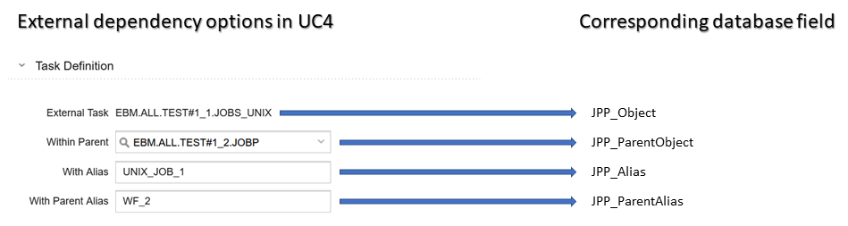

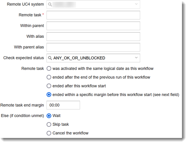

    I have developed a proof of concept for a workflow that can be used as a drop-in replacement for external dependencies. The dependency options are specified via a prompt set. A REST job fetches the remote task status, and a second REST job fetches parent task info if necessary. Retries are accomplished via task post-conditions.
    All of the checks up to and including the check for same logical date are working. The remainder are yet to be implemented, and may not be depending on how many people are actually using these options today.
    And speaking of that, here's a little SQL query I wrote that lists all but the most commonly used types of external dependencies in the AE DB.
    SELECT OH_Name, JPP_Object, JPP_ParentObject, JPP_Alias, JPP_ParentAlias, JPP_ExtWhen, JPP_ExtSLTType, JPP_ExtSLTWithin,
    JPP_ExtElse, JPP_ExtElseAlarm, JPP_ExtTimeout, JPP_ExtTimeoutE, JPP_ExtTimeoutA, JPP_ExtExecute, JPP_PreCntExt
    FROM OH LEFT JOIN JPP ON OH_IDnr = JPP_OH_IDNR
    WHERE OH_CLIENT = 100
    AND OH_DeleteFlag = 0
    AND ( JPP_ParentObject IS NOT NULL OR
    JPP_ParentAlias IS NOT NULL OR
    JPP_ExtElse <> 0 OR
    JPP_ExtElseAlarm <> 0 OR
    JPP_TimeoutFlag <> 0 OR
    JPP_ExtExecute IS NOT NULL )
    ORDER BY OH_Name, JPP_ParentObject
    This will help us to get an idea of how prevalent the different kinds of options are, so that we can decide which ones are worth the effort of recreating in the dependency checker tool.

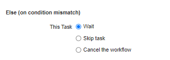

    The PoC has now evolved into a nearly feature-complete remake of the External Dependency feature, but for cross-system dependencies. I'm just working on a few remaining details, and I have a few questions:
    • When the mismatch option is set to wait, how often is the dependency checked? (In one test, it looked like it was every 20 seconds.)
      • When the option to execute an object on mismatch is also enabled, is this object executed every time the dependency is checked and fails to match?
    • There is only one field for object to execute upon mismatch and/or timeout. Is there in way to tell in the called task, whether the task was called due to a mismatch or timeout?
    • If the mismatch or timeout option is set to skip, the external dependency task ends with the status ENDED_SKIPPED. Successor tasks might be configured to act upon the basis of the predecessor's status. Is there really no way to force a task (e.g., a workflow) into the ENDED_SKIPPED status, to mimic the behavior of external dependency tasks?

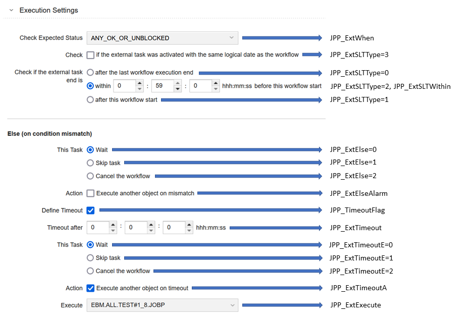

    I'm trying to find out how prevalent the same logical date option is in the external dependencies in our UC4 systems.
    I cannot find the field in the JPP table that stores this information. Does anyone know?

  • 17.  RE: Dependencies between UC4 systems
    Posted Nov 22, 2022 08:55 AM
    Hi Michael,
    so now, I think you are looking for
    jpp_extslttype = 3
    table jpp
    Thx & rgds
    Christian
    Managing Consultant
    Setis GmbH
  • 18.  RE: Dependencies between UC4 systems
    Posted Nov 22, 2022 09:12 AM
    Edited by Michael A. Lowry Nov 26, 2022 09:06 AM
    Yes, that's it! This is not documented in the JPP Table schema documentation.

    To clarify, I'm looking for the field in the JPP table (or other table) that stores the status of the checkbox Check if the external task was activated with the same logical date as the workflow in the external dependency.
    Thanks to @Christian Boeck for answering the question. My current understanding is depicted below.
  • 20.  RE: Dependencies between UC4 systems
    Posted Nov 23, 2022 04:40 AM
    Edited by Michael A. Lowry Nov 26, 2022 09:04 AM
    Given how the controls work behind the scenes, I've reworked the PRPT a bit, combining the two timing-related controls into one. I also reworded the options to make them easier to understand.
    I'm not sure why the task timing options are implemented via two separate controls in the AE when a single radio button control is sufficient.
    Broadcom, feel free to use the above idea in a future product update. :)

      I'm continuing my work on developing a drop-in replacement for the External Dependency capability of the Automation Engine, that facilitates creating dependencies between separate AE systems. As a part of this, I'm trying to understand the various External Dependency options. I learned something that I thought others might be interested to know.
      There are effectively four different options for specifying the required timing of the target task:
      1. External task was activated with the same logical date as the workflow containing the external dependency.
      2. External task ended after the end of the last execution of the workflow containing the external dependency.
      3. External task ended within a certain margin (hhh:mm:ss) before the start of the workflow containing the external dependency.
      4. External task ended after the start of the workflow containing the external dependency.
      Option #3 is described in the documentation in a way that suggests a slightly different behavior than what I've observed in my tests.
      The External Dependency documentation includes this description and figure:​
      Select hh:mm:ss before this Workflow starts to define the period within which the external task must have ended.
      The period that you define here starts before the current execution of this Workflow starts.
      Graphic showing a Worlflow with an external dependency, the period defined as 60 seconds and the end time of the external task within this period.
      The wording and figure suggest that the external task must end within the 60 minute period immediately preceding the start of the workflow containing the external dependency.
      My tests revealed a slightly different behavior.
      • The external dependency is not resolved if the external task ends before the 60 minute period immediately preceding the start of the workflow containing the external dependency.
      • The external dependency is resolved if the external task ends within the 60 minute period immediately preceding the start of the workflow containing the external dependency.
      • The external dependency is also resolved if the external task ends after the 60 minute period - that is, after the start of the workflow containing the external dependency.
      I guess this is the intended behavior, because if the dependency could not be satisfied by a task that ended after the start of the workflow , one could end up in the situation wherein because the external task ended too late, no subsequent execution could ever resolve the dependency.
      I believe the documentation could be more clear though that with this option enabled, there is only an earliest accepted end time of the external task, and not a latest accepted end time.
      Ping @Gabi Oberreiter.

      Isn't it dependent on what you have selected in the Else section?  So if it doesn't fall within the 60 minutes prior to the start of the workflow with the external dependency, then it can potentially Wait, Skip task or Cancel the workflow depending on your selection.
      From the external dependency documentation.
      "Important! If the external dependency end time does not lie within this period, the successor task in the Workflow is not processed and the settings in Else (on condition mismatch) are applied."

    • 32.  RE: Dependencies between UC4 systems
      Posted Feb 16, 2023 08:37 AM
      Edited by Michael A. Lowry Feb 16, 2023 08:53 AM
        |   view attached
      Here's the tool I developed.
      EXTDEP tool for defining dependencies between AE systems
      Attachment(s)
      zip
      EXTDEP_v1.0.zip   18 KB 1 version
