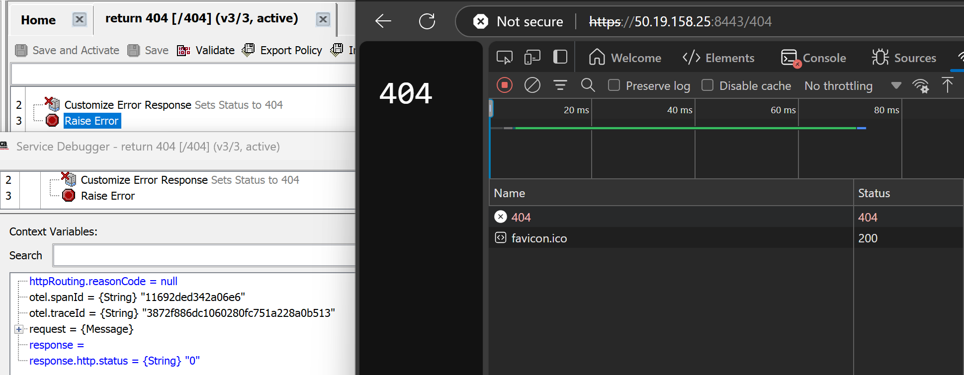

    I'm wondering how to best capture response status codes for custom error responses.
    For instance, if I use the Customize Error Response Assertion, and set the response status to 404 in the assertion, I don't see that value in the ${response.http.status} variable.  If I were to return a template response rather than an error, I would see the response status in that variable.
    A little policy to demonstrate:
    The status shows up in the browser, so it has to be somewhere, but I also see that ${response} doesn't have any information.
    If best practice is to have another context variable to reference the response code and then reference that in the custom error response assertion, that's fine, but maybe someone knows where the variable is set, and if it can be referenced.

    Jon, as I understand what was just explained to me (thanks Charles L), the error response exists outside of the scope of the policy... the assertion is actually overriding the default value in the Tomcat thread that is handling your session.  It is not a variable in the policy because the policy may terminate unexpectedly and you still want the error to be sent.
    I suspect an assertion COULD be created that reads the current error response (presumably if we can set it from policy we could read it from policy), but since your setting it, you can probably just use a variable as you described.
    You MIGHT be able to reference it in a message-completed global fragment?  But that still won't appear in the debugger.

    In your example you don't have a ROUTE assertion so httpRouting.reasonCode will always be NULL.

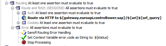

    Then dealing wih ROUTE assertions:
    Here when ROUTE fails, it will call the 'Error" bloc and our 'Sanofi Routing' encap will handle the httpRouting.reasonCode and convert it if needed, filling-in 'status' variable and 'error.msg'. error.code is then set to this status and the Stop processing will "call" the Custom Error Response

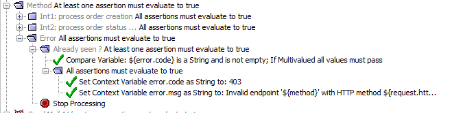

    For other error checking:
    If any one of Int1 or Int2, it will call the Error bloc. if error.code already set (in Int1 or Int2 blocs), it will just fail and call 'Custom Error Response', otherwise it will default an error code and msg, and fails.
