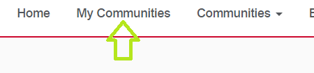

    @Steve Holton Thanks for replying with those details.
    @Maureen Brown We also have a community specifically for Gen. If you'd like to seek feedback from other Gen users, posting to that group may also be a good option. Here is a link to the Gen EDGE community: https://community.broadcom.com/mainframesoftware/communities/communityhomeblogs?CommunityKey=4182c217-4789-4997-8f22-87de25983f6e. Once you have joined, it will appear in "My Communities" in the top menu of this site.
    Have a great day!
