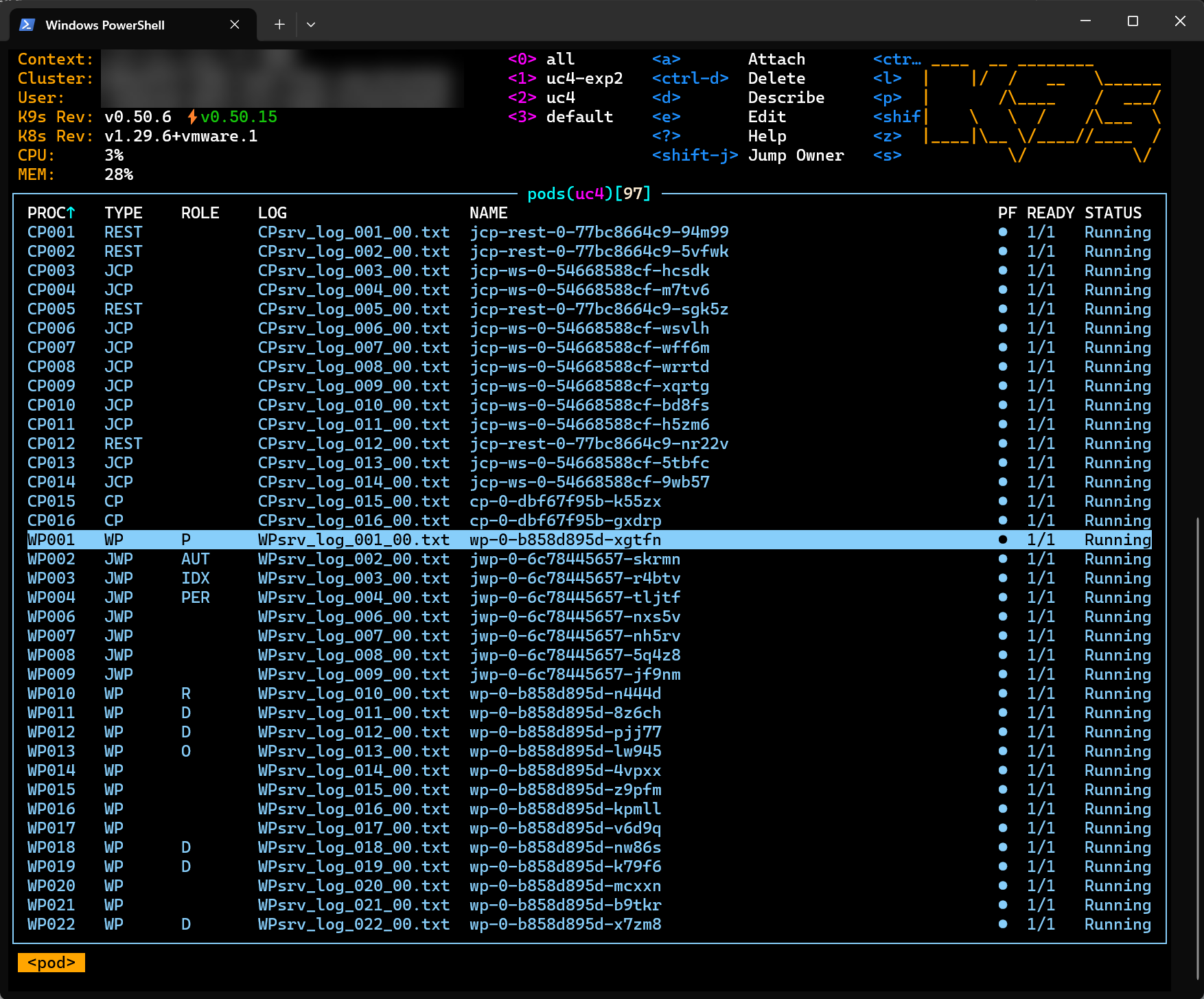

    Here is a screenshot of K9s, showing a cluster with labeled AAKE pods.
    These are based on my older Bash functions to identify AE server processes.
    If some processes display without complete information, you may need to tweak the parameters of the search_logs function in the various places this function is called, so that it searches older (or higher generation) logs. The right settings will depend on the particular system and its level of activity.
