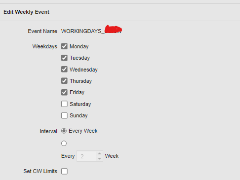

  • 8.  RE: Automic Calendar Events
    Posted Jan 14, 2025 06:07 PM
    What does your WORKINGDAYS_xxxx keyword look like?
    Right now, you have this configured to start with the 1st day of the month, and count off the next 8 valid days from your WORKINGDAYS_xxxx keyword.  If that keyword isn't excluding Saturdays, Sundays, and holidays, then that's your problem -- you're literally just adding 8 days (not necessarily 8 *business* days), and then offsetting the result based on whether it falls on a Saturday or Sunday.  Your WORKINGDAY_xxxx keyword should be using those same exclusions for Saturdays and Sundays.
  • 9.  RE: Automic Calendar Events
    Posted Jan 15, 2025 03:43 AM
    hi Daryl
    see attached.  where can i get training...i am struggling!
    please..how can i get this to work? :(
    thank you for all your assistance thus far.
  • 10.  RE: Automic Calendar Events
    Posted Jan 15, 2025 10:34 AM
    Edited by Daryl Brown Jan 15, 2025 10:40 AM
    Oh, I see the issue.  (Took me a bit!  Don't worry; you're close.)
    You're using a starting event of the 1st day of the month, rather than the 1st working day of the month.  (What you've effectively defined right now is the "8th working day following the first day of the month", which is not quite the same as the "9th working day of the month".)  To find the 9th working day of the month, you'll need to start by knowing when the first working day of the month is, not just the first day itself.  So you'll need to define yourself a 1ST_WORKING_DAY_OF_MONTH -- basically just like you have it above, but without the additional 8 days offset.  (Change that part back to 0.)
    Next, to correct your 9TH_WORKING_DAY_OF_MONTH, you'll just need to change your starting event from 1STDAYOFMONTH to 1ST_WORKING_DAY_OF_MONTH.  Once you do that, you won't need to worry about the Saturday and Sunday exceptions, as you'll already be skipping over those by virtue of postponing by dates already in your WORKINGDAY_xxxx event.
