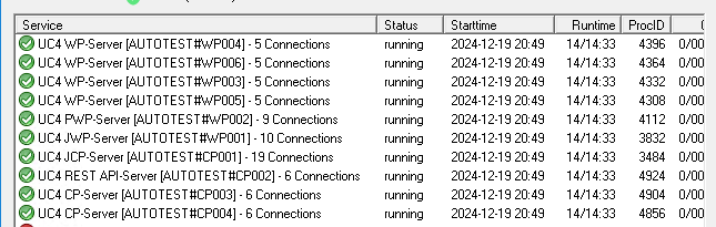

    Hi Daryl, thanks for the reply. I assume when you say DWP you mean WP's? In non-production we have 4 WP's, and 1 JCP. We don't many many users but at most we would have 5 users connected to non-production at once.

    DWPs -- Dialog Work Processes -- are a specialized form of WP that are dedicated to handling AWI requests, as opposed to executing tasks.  See https://docs.automic.com/documentation/webhelp/english/ALL/components/DOCU/24.1/Automic%20Automation%20Guides/Content/AWA/Admin/admin_types_of_server_processes.htm?Highlight=DWP#link4.
    From the AWI, if you select one or two of your regular WPs (not the PWP, and not WPs with a role of R or O), you should be able to do a right-click>Server Mode>Change server mode to DWP.  My guess is that you'll notice an improvement in AWI performance after that.
    I would defer to the System Sizing doc --  https://docs.automic.com/documentation/webhelp/english/ALL/components/DOCU/24.1/Automic%20Automation%20Guides/Content/Installation_Common/install_AWA_ARA_sys_requirements_sizing.htm?Highlight=dwp -- to get a sense of how many WPs/DWPs (and other processes) you should have.  Based on what I'm seeing there, you may want to spin up some additional WP, JWP, and/or DWP processes for your server, too.

    Daryl, so far I have seen drastic improvement from what I was experiencing before. I did upscale the amount of DWP's from the recommendation just to be safe. Have you seen any harm come from that?

    In terms of adding additional AE processes, I've had that question as well, as we now have a lot more running than we did back in v12 -- we now have 2 CPs, 2 DWPs, 2 JCPs, 4 JWPs, 1 REST, and 4 WPs per AE in our prod environment -- but I haven't noticed any problems arise from it.
    I have still occasionally dealt with some AWI slowness, but I think those might be network-related issues in our case.  But when our Ops team has informed us of really poor AWI performance, I've usually found that our DWP count is lower than it ought to be.
    Note -- check out the WP_MIN_NUMBER setting in your UC_SYSTEM_SETTINGS var, too  --https://docs.automic.com/documentation/webhelp/english/ALL/components/DOCU/24.1/Automic%20Automation%20Guides/Content/AWA/Variables/UC_SYSTEM_SETTINGS.htm?Highlight=uc_system_settings . This setting will ensure it automatically toggles any excess WPs into DWPs for you.  Otherwise, you'll need to toggle them manually back to DWPs whenever you restart your AE server.
