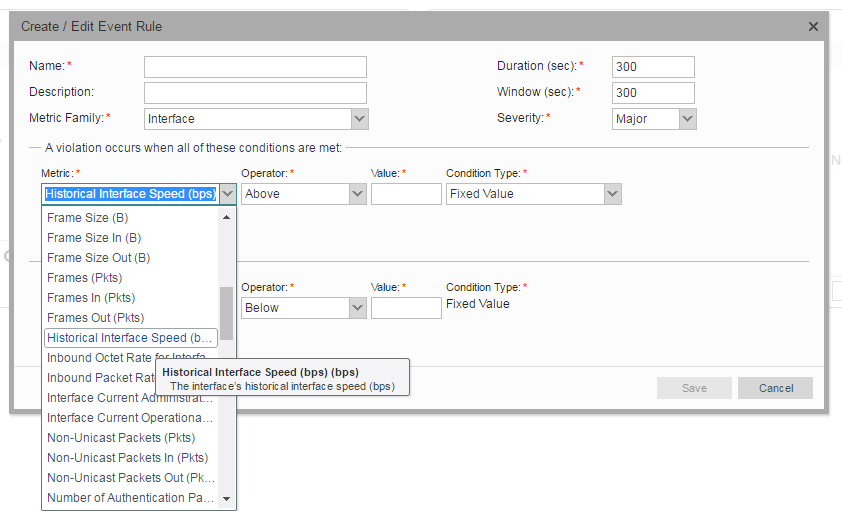

    Against the OOTB Interface Metric Family there are a few speed related metrics we can alarm against.
    There is the Historical Interface Speed:

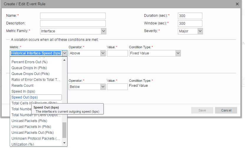

    Speed In and Out:

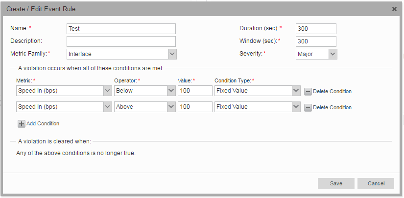

    I haven't tested such a rule, but it appears you can configure one like this:
    That can be set for comparison to a Fixed Value or a Standard Deviation.
    Any chance any of that would meet your needs?
