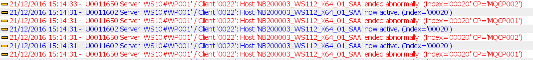

    Automation Engine version is inferior to the Agent's version
    For instance AE version 11.2 with a v12 OS agent
    This is not supported - the Automation Engine is only backwards compatible - and will cause this error to occur at agent startup :
    dj9hs3k67i9i.pnghttps://us.v-cdn.net/5019921/uploads/editor/hz/dj9hs3k67i9i.png" width="1068">
    Foot note : Automic's recommendation is to have matching versions. Backwards compatibility should essentially be used during a transition phase when upgrading the Automation Engine server.
