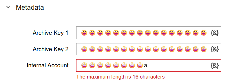

    I did some tests and found that AE-36575 is not completely fixed in v24.2.
    Bug
    Several fields are cut off when using Unicode characters when saved over Application Interface and AWI.
    A problem has been solved where several fields are cut off when using Unicode characters when saved over Application Interface and AWI. For example Archive Key 1/2, Int. Account and Source/Target paths were affected.
    AE-36575
    KB article
    Mismatch between AWI field validation and AE DB storage for IntAccount field.
    This is due to 2 defects in the Automation Engine
    • Length check in JAVA Api checks for code units and not bytes. because of this, there is no error message returned on "save" - but the value truncated afterward by UCUDB32
    • REST API also allows the storage of more data than UCUDB32 can read.
    KB367043
    In my tests, it was possible to insert only 8 four-byte UTF-8 characters in the IntAccount field.
    Allowed: πŸ˜€πŸ˜€πŸ˜€πŸ˜€πŸ˜€πŸ˜€πŸ˜€πŸ˜€
    Not allowed: πŸ˜€πŸ˜€πŸ˜€πŸ˜€πŸ˜€πŸ˜€πŸ˜€πŸ˜€a
    If one attempts to enter one more character, the AWI displays the error message: The maximum length is 16 characters.

    Broadcom has updated KB367043 with a note acknowledging that the problem is only partially fixed in v24.2.
    This is partially fixed in v24.2.0 (available): It is no longer possible to store invalid information in the database.
    A second fix is underway as part of a general improvement: The field IntAccount will be extended to 200 characters (up from 16). This improvement will also fix the live field validation in AWI. In other words, before saving it will show a warning message if the content is not accepted.
