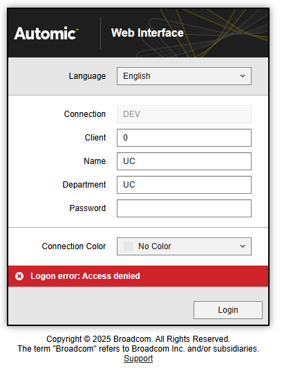

    We upgraded AE to version 24.3 and we are getting access denied in our AWI when trying to log in.

    We have completed the Upgrade for both Engine and remote agents successfully. The certificates for the agents need to be tweaked due to increased security checks.
    Also, once you log into client 0 with the local user you need to change TLS parameter from Y to N in the LDAP VARA object in order to be able to log in with LDAP users.

    For some reason they decided to stop returning the actual reason the connection failed.
    In V21, if the JCPs aren't available or you have the wrong port numbers, it says...
    Connection to the AE system not possible.
    No connection to the following CPs could be established
    In v24 it just says "access denied".  Same with certificate issues, bad passwords, and wrong system name. Just Access denied.
